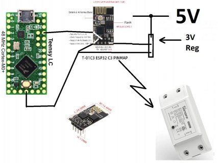

I have developed a project where I turn a valve on/off switched by a Sonoff Basic2, commanded by an ESP32-C3 over WiFi controlled by just ONE Teensy pin.
Below is a schematic picture of the bit used.
The ESP32-C3 in the form of a T-01C3 sends a control message to the Sonoff Basic2 to turn it's Relay and Led on or off.
In order to do this the Sonoff MUST have it's re-programmed to accept ESP_Now commands.
The code for this firmware is shown below. To re-program it follow the method shown here.
During operation the ESP32-C3 is sent to DeepSleep. It is woken up by the Teensy, by the Teense setting a pin low (the ESP32-C3 can use high or low). I have found by experiment that an ESP32-C3 takes circa 43.5ms to become fully compos mentis.
Therefore we can put our wakeup pin LOW for ~10ms to start the ESP32-C3 wakeup process, then decide whether we want to have the Sonoff turn it's relay (and led) on or off. If we want it off we leave the WakeUp Pin LOW for ~70ms more so that the ESP32 will have time to read the pin and determine it as a LOW and send a message to the Sonoff to turn off. If we want the Sonoff to turn on we set the Wakeup pin HIGH after the 10ms initial pulse.
Below is the software for the three devices:

This one is now in the queue for a blog article. Quick question though, is the Teensy's main purpose just to keep the ESP in a low power mode when not needed? I guess I'm just struggling to understand the project as a whole. Any extra explanation could really help so we get the article writeup correct.
Also another photo of the project actually installed and working could really help for a good article to show what it's really doing in practice. The code and technical detail is of course good, but explaining the real end-use application helps put it all in perspective for an article read by people not (yet) focused on the implementation.
That post was to show how to be able to (cheaply) remotely control mains (240V in UK 110V elsewhere) voltage from a Teensy.
The project is still ongoing, which is intended to have whole house control of central heating down to individual radiator level.
The Teensy seen here will sit on the wall monitoring temperature and humidity and remotely turn the radiator on/off using the Sonoff Basic which will apply power to a radiator valve.
As mentioned the whole project is intended to be low cost whilst providing the maximum of control and comfort
The Sonoff basic can be purchased for $3.50, the ESP32-C3 for $3.56 ( or an ESP8266 for < 1$).
The wall mounted thermostat is intended to be battery/mains powered, hence the use of low power mode and an LC.
