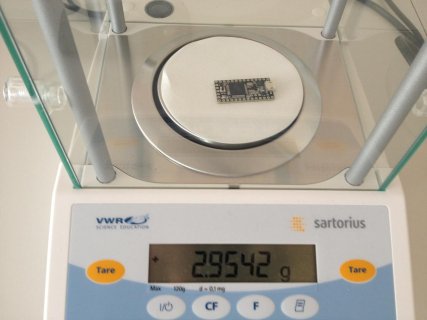

I recently came across your website, and I think I found the Exact product I am looking for.
After looking over your website thoroughly I cannot find the actual weight of the teensy 3.0 unit.
I understand that it's Very light, but would you be able to weigh the actual board?
So far, the chopper I want to buy is able to have a payload of 400 grams.
if I have the weight, I can start the rough idea of the planning phase of my project.

it.. really really light 1 to 0.5 grams... "i'm guessing"
But weight will increase as you add solder joints or even headers.
Or as I like to call it the LEAD Zeppelin effect.
My board weighs 2.9542g ;)
I measured 0.105 ounce. With pins soldered, it measures 0.170 ounce. My scale is about 15 years old and has never been recalibrated or verified for accuracy (it's mainly used as a "counting scale"), but this is pretty close to Ben's measurement. :)
