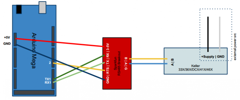

I'm using the same RS485 breakout from sparkfun with a Teensy 3.0 at 9600 baud. It runs for days without problems.
Connected as the image below. (3-5V/VCC from the RS485 breakout is connected to Teensy's 3.3V )
note: rx goes to tx and vice versa.
RTS has to be high when the Teensy does write to the RS485 Bus (and low to receive).

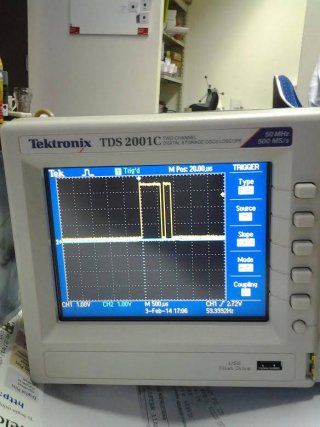

Attached waveform on Pin0. It looks working fine all the way.
I tweaked the delay between chunks and found that 0.1 second will not cause problem of the serial, but 0.2 second sleep will make it sleep forever.

Hi Paul,
Here is the update. It seems the problematic rs485 breakout's power level for idling is 0v instead of 3.3v. Thus it confused Teensy hardware serial. Though I'm not sure why Serial2 and Serial3 seems pretty happy with this.
I think it doesn't worth much effort to cater for the irregular voltage level.
I have attached waveform on the pin0, if you'd like to refer to.
Thank you very much for your attention.

Being low for more than a character time or so generates a break condition which might be a factor.
Oh, I see. Does adding a 10K pullup resistor on RX1 make it work on Serial1?
No it didn't really work. The RS485 breakout pulls to ground when it is idle. Even if i put a 120Ohm pull up it barely manage to pull up to 1.x V on idle. I think the RS485 breakout is beyond repair if I'm not wrong.
is the 'scope displaying inverted data? The UART has an invert option config bit IIRC.
Hi Steve,
Do you know how to invert the data? The UART you mentioned as in the UART in Teensy3 or the RS485 breakout? I couldn't dig it out though.
Actually my finding seems that the space and mark are identical to a brand new RS485 breakout. Just that the idle is different. It might not be inverting, just being pulled down on idle. I might be wrong though.
If you can advice how to set the inverting config, I can give it a try.
