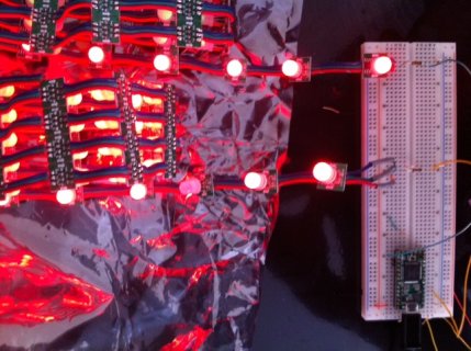

I am getting weird results running OCTOWS2811 on the Teensy3.1

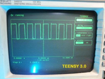

If I install a Teensy3.0 in the breadboard, and compile it for Teensy3.0 works great, slow smooth color transitions.

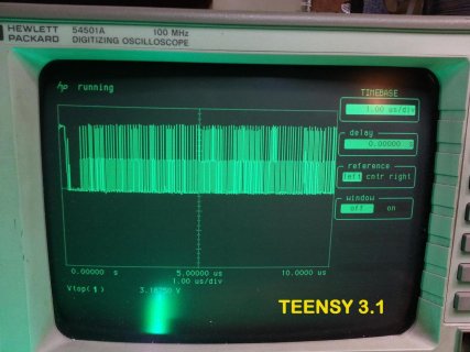

If I swap it for a Teensy3.1, and recompile it for Teensy3.1, I get flickering and jittering random colors.

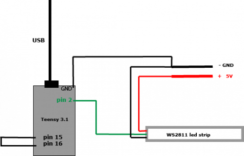

The breadboard is wired just like in the example with 100 ohm resistor and jumper on pins 15-16.
I get the same results with the example rainbow sketch.
I have another Teensy3.1, so I'll solder up some pins and give that a try.
Is anyone else seeing similar issues.
