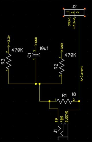

My first steps I think will be to try measuring current. As I mentioned in previous post, I can maybe deduce the tank is full from how the current turns off. I also can probably get that information directly from the top float. It runs on it's own circuit, which when on I believe throws big relays, that allow power to go the two wells...

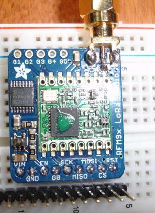

Yesterday I ordered two more T3.2s plus a couple of RFM69s from Sparkfun, to try. As a secondary option I also ordered a couple of the Adafruit Feather M0 with LoRa, just out of curiosity. They talk about 1.2m line of sight, so hopefully 100-200 feet maybe through a wall/window... they will be able to communicate.
