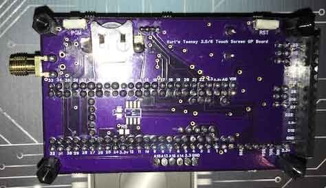

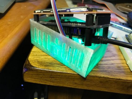

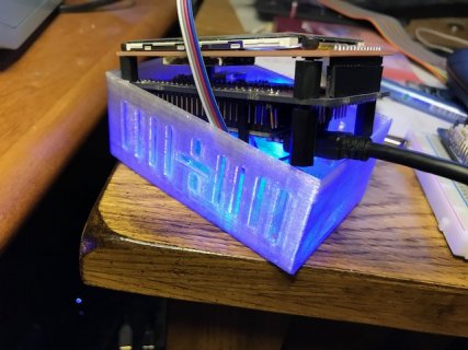

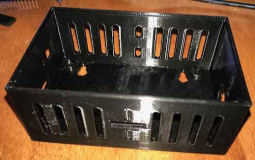

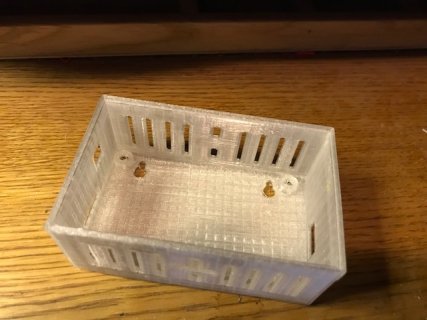

Another quick update. Finally printed updated box with T-Glase. Took a few attempts to get it to stick to plate of 3d printer...

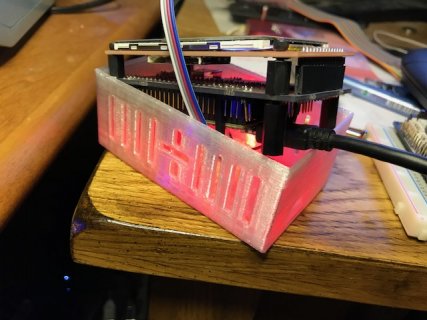

It may not look as clean as black, but what is fun is how it works with light. That is I propped the older board into it and you can see how the neopixel changes the box:

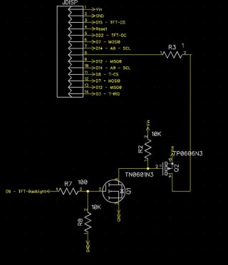

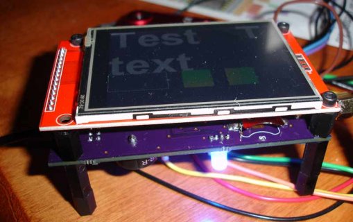

Code wise, I verified that the new boards TFT backlight support is working. That is I can now control the brightness of the backlight. I have it dim down every 10 seconds until a minimum and go back to full brightness if I touch the display.
