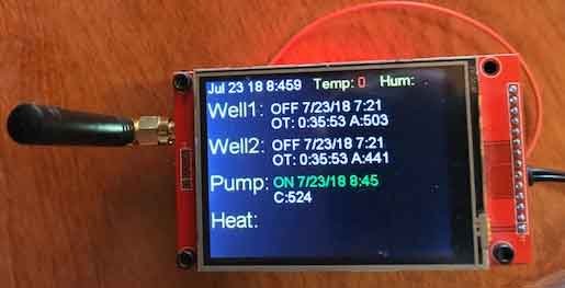

But tack onto using Teensy. Some of the basics appears to be working somewhat now, with the two Teensy boards talking to each other, the current sensors are detecting when the pumps turn on and off. It also records this data to an SD card. Every 5 seconds the one in the pump house tries to send a packet with state information... the one in my office receives enough of the packets to display the information... There are some display bugs, plus I want to assemble second display with my updated card... And then once I think this is working reliably, I will add some additional stuff, like not only just remembering the last times each pump turns on and off, but also remember how often they do this and maybe plot it, and keep trends...
But here is showing simple output from today!
I know there are a few display errors like the date time... But it shows both wells turned on at same time (highly probably float turned them on). And it shows both pumps turned off at same time, again most likely float turned them both off... So very likely tank FULL.
