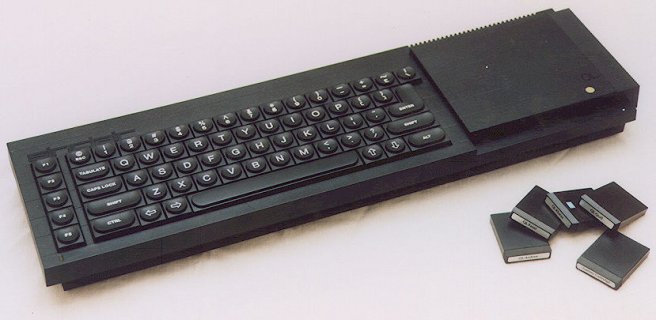

The Sinclair QL was Clive Sinclair's attempt to produce a business computer, after his success with home computers like the ZX81 and ZX Spectrum. It had a price point of £399 in 1984 when PCs started around £2000, so was pretty revolutionary. It also included a functional office suite, which definitely cost extra on PCs of the day. Unfortunately it was hit by production delays and reliability problems, particularly with the "Microdrive" alternatives to disk drives. Ultimately I think it failed because Sir Clive didn't understand that you can't treat the business market the same way as the hobby market.
But it was still a very beautiful computer:
As you can see, the keyboard was the entire computer, with the Microdrive cartridges slotting in to the right of the keyboard.
My plan is to replace the computing element with a Raspberry Pi, but I would like the keyboard to look like a regular USB keyboard.

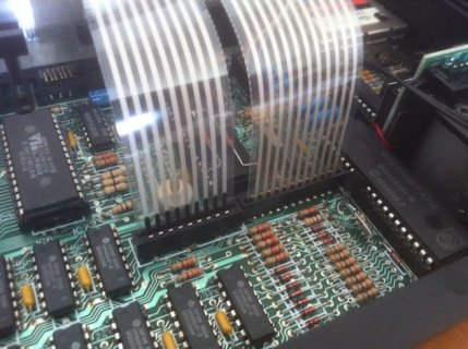

Inside the case, the keyboard was connected to the motherboard by two ribbon connectors:
These I plan to connect to the Teensie board, which will be connected to one of the Raspberry's USB ports. However, the first part of the project is just to make it work as a USB keyboard.

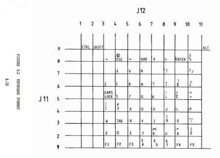

The following diagram shows the keyboard matrix:
My understanding is I will need to configure the "J11" pins as outputs, and the "J12" pins as inputs. If I send a high signal out each J11 wire in turn and test for input on each J12 wire, it will tell me what key (or keys) has been pressed. I simply need to send the appropriate keystroke down the USB.

As others have noted, the keypad library is designed for exactly this task. You tell the library how many rows and columns, and define a matrix to specify the character generated by each row and column combination. You already have that info in the diagram you posted.
One observation - at first glance this is an 11 by 9 matrix but looking closer it is actually a 8 by 8 matrix (columns 3 to 10 on J12, rows 1 to 8 on J11) plus three extra columns and one dedicated row for the modifier keys. I suggest wiring it up like that, so each position in the matrix corresponds to an actual character and the three extra lines, which you can read using a normal digital read, just give you shift states. Those need to be separately handled anyway by the USB keyboard code, so that makes it more convenient.

Thanks for all the tips. I'd picked the Teensy for the ease of simulations a USB keyboard, but I hadn't even spotted the keypad library, which seems perfect fir my needs. You're right that it's actually an 8x8 grid plus modifier keys.
There some oddities if the keyboard, such as the lack of a dedicated backspace key, which was achieved by pressing ctrl+ left arrow, so I'll have to do some coding to fill in the gaps. I'm thinking of having a switch to select between different modes of emulation, but I think the Teensy 3.1 should have more than enough channels to handle it.
