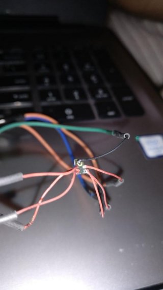

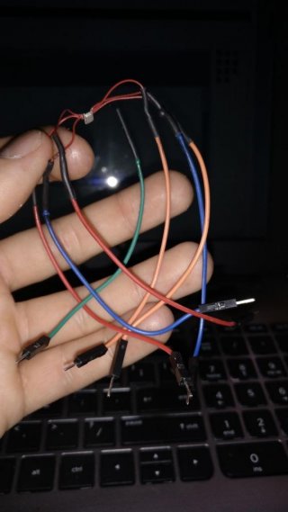

First of all this is a picture of how I did to take out some jumper-conections from the mic
![Sol.jpg Sol.jpg](https://forum.pjrc.com/data/attachments/11/11718-d89e2996bf8a0028bc74c94a16c0fa39.jpg)
![Cable.jpg Cable.jpg](https://forum.pjrc.com/data/attachments/11/11720-425d3e1b2fed4d921dadc9ef45a98130.jpg)

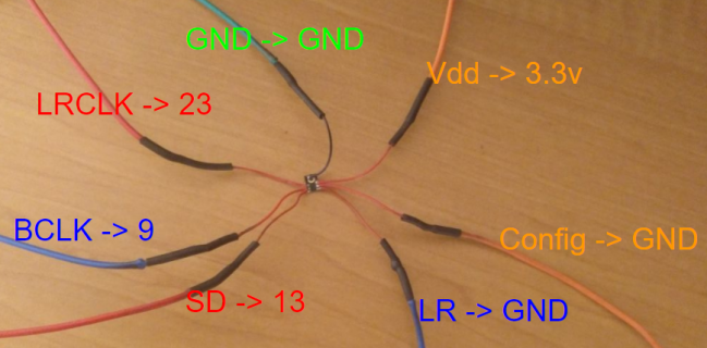

Micro -> Teensy 3.6
SEL -> GND
LRCL -> 23
DOUT -> 13
BCLK -> 9
GND -> GND
3V -> 3.3V
I'm using a capacitor and a resistor which were recommended by the DataSheet of the mic. With or without these elements I get the same zero values.
