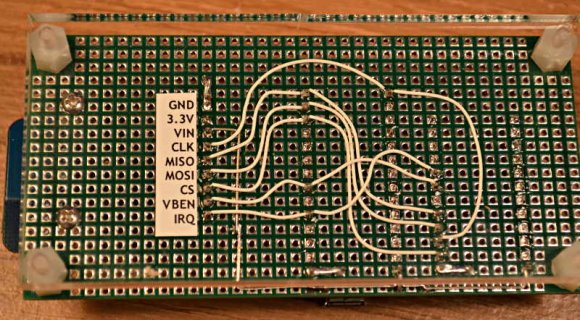

Uno - compiles with no errors, 'buildtest' example runs with no issues.
Teensy3 - compiles with no errors, hangs on "Initialising the CC3000 ..." in buildtest.
I don't think the Teensy3 problem is related to your patch, it looks like it's hanging on init_spi(). This is the first time I've tried the Adafruit library with a Teensy3 -- has this worked for anyone? (my test code https://github.com/cmagagna/ArduinoCC3000Test runs so I know the wiring etc. is good).

I personally verified this works on Teensy 2.0, Teensy 3.0 and Arduino Uno
Everything is still failing with a Teensy3 + Adafruit board I upgraded to the new T.I. firmware version 1.24
Paul S said ... using 1.19 firmware
Potatotron said ...
Question - @ Potatotron does 1.19 work on the Teensy 3 and all of the examples?![]()
