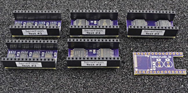

Actually, I'm still in the process of building up hardware to test all those chips.
(click for full size)
As you can see in this photo, one of the OSH Park boards only recently arrived and hasn't even been soldered yet. But eventually these boards will let me test all those chips, with much less effort than I did fiddling with the first 7 parts.

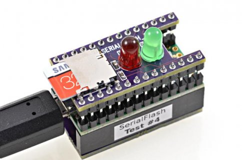

Update: here's the test board.
Thanks for the update, Paul.

Sorry to report that I have not done anyhing with the SPI memory chips yet.
