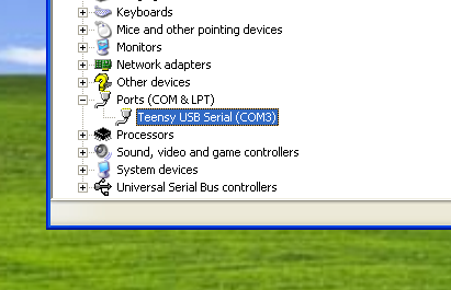

I'm hoping for some feedback from anyone using Windows with the new driver.
Yes, 1.18-rc3 has changed the Windows driver yet again.
You can tell which driver is being used by the specific words that appear in the Device Manager.
- "USB Serial (Communication Class, Abstract Control Model) (COM #)" - The 1st, oldest driver
- "Teensy USB Serial (PJRC.COM) (COM #)" - The 2nd driver
- "Teensy USB Serial (COM #)" - This 3rd, newest driver
