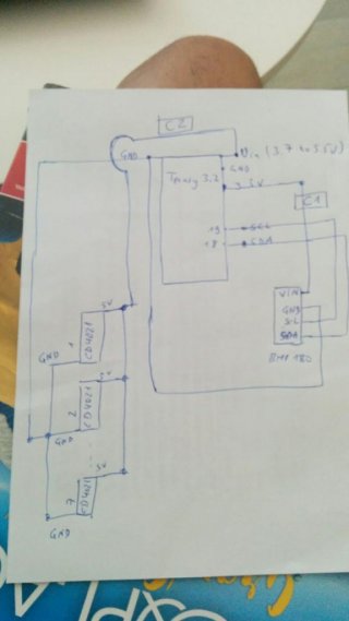

Hello,
it would be very nice, if you could help me.
I have some devices, which I used in the same circuit. Seven shift register "CD 4021" in daisy chain with hall effect sensors , and a BMP 180 pressure sensor.
They need different power supplies. The shift register needs at least 3.8V and the BMP 180 3.3V.
Is it possible to connect them to different pins of teensy(shift register to Vin pin, BMP 180 to 3.3v pin) for power supplying?
Or do I need a level shifter to connect both to the same pin. I prefer to not use a level shifter.
PS: The BMP 180 has a I2C interface and is a china product.

I added a sketch(not very nice). I marked the tow connection, which I mean as C1 and C2.
Question, is it okay to have this both connection

Your circuit is fine, using the 3.3 v output with 5 volt Vin power. Note that to program Teensy by the USB port, you must first disconnect the Vin power source.
If necessary, you can isolate Vin from Vusb by cutting the very small trace from between to two larger pads shown below. This allows powering from Vin and programing via USB simultaneously but it is not without a risk to a powered Teensy when the USB connection is made. Most computers internally connect together earth ground and common of the USB power. This may create a "ground loop" if the Teensy ground potential is not at zero volts with respect to earth. Bad things can happen if the difference in potential is great or it has significant current ability.

It is nice to hear, that my cricut is fine. I am sorry, I am a little bit confused about your explanation. The Teensy is only powered via USB and not via Vin. I only use Vin as a source to power the shift registers and the hall effect sensors. As I heared, cutting the trace is for powering the Teensy by power supply and programming through USB simultaneously.
I think the confusion is you say 'separate power supplies' but you show seem to show sharing USB common power.
Vin is connected to USB power unless you sever the internal connection.
Otherwise you can power 5V peripherals with it up to the current limits of the USB source.
But in your case I suspect you can power everything from the 3.3V on-board power regulator.
The sensors can't use 5V power (from the data sheet I saw) so you need to take power from 3.3v power regulator pin (supplies a max of 250mA @ 3.3V).
The shift register should work at 3.3V (ancient or not) but you can power it at 5V even if the hall effects can run at 3.3V.
If you use 5V power for the hall sensors you will need a Teensy that is 5V tolerant on it's input pins (T3.2 or T3.5) but, again, I don't think you will need to.
