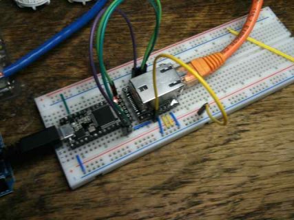

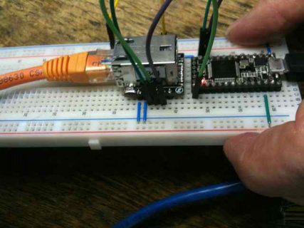

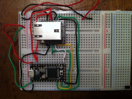

Thanks but that is not the problem. I have the MAC code of the teensy already but using that MAC code I do not get the expected result (the IP address) from DhcpAddressPrinter. I suspect that I need the MAC code of the WIZ820io itself for that to work unless people say other wise. Should I look at the teensy WIZ module as one entity with one IP-address and MAC address? As stated before. I don't see the WIZ in my network and I cannot address it from the teensy either. I think the module works though since the orange light burns permanently and the green light semi permanent (with a few flickers once in a few seconds).
Best, Hans.
The WIZ820io (or the older WIZ812MJ for that matter) have no burned in MAC address. Only the newest member of that product family using the W5500 chip have that. That's why the teensy 3.x mac address came in so handy. Ethernet is exactly the reason that it exists if I remember Paul's comments in previous threads correctly.
Please post what hardware you are using, how everthing is wired up (is PWDN connected to GND ?) and post your Sketch.
The sketch segment I posted works in my Sketches on my own Teensy3 WIZ820io adapter board and I have no problem to receive an IP address per DHCP, ping it, send receive UDP messages or register a Bonjour service on my network!

I use this standard code to get the IP address. The MAC address is the teensy address.
Sketch looks OK at first sight. What hardware are you using ?
Or more specific, how is the WIZ820io connected to the Teensy 3 ?
I tried to upload some pictures and hope I succeeded. I have it hooked up just like it is done in the tutorial on the wizwiki: http://wizwiki.net/intro-to-the-wiz820io-module-by-ben-roberts/
The only thing that I changed is that I put the reset on 3.3V (since I don't have a pin on the teensy on the reset) and I connected PWDN to GND.
You need to connect the RESET in of the WIZ820io to pin 9 on the Teensy 3.x.
It is used during the initialization of the WIZ820io. See this code out of the Ethernet library in /utility/W5100.cpp:

Dear Headroom,
First of all thanks for your time. I really appreciate this but I am afraid the problem is still not solved when connecting 9 and reset. I did not replace the W5100 files in the first place since I suspect the ethernet library to be updated and seeing the W5200 in the code. Do you also use the standard ethernet library as part of the Arduino IDE? I went to the WIZNET page and went to that link to the W5200 replacement of the W5100 chip. Having that library installed I got error codes. There was something else there though:
3. Note: libraries/Ethernet/Ethernet.h needs the following at line 10 instead of #define MAX_SOCK_NUM 4, since it doesn't #include "w5100.h" anymore:
Thanks "Matthew Lange"
#ifdef W5200
#define MAX_SOCK_NUM 8
#else
Did you change that in your library?
Best, Hans.

I put the wiznet 820 on the breadboard to take a photo of a working wiring setup, and this setup does work:
Dear Mortonkopf, I appreciate your effort but my hardware configuration is exactly the same...
I think I should run diagnostics on my ethernet port. Having tested two modules, three ethernet cables and three teensy's and an Arduino the problem is still elusive to me. I think I will test with another computer.
