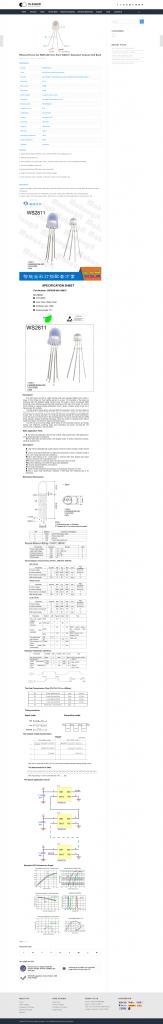

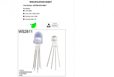

However, I'm not sure that you’re right. According to the specs, 3.3V should be OK as long as it is used for both power and logic high:
Those are the specs for four legged through hole LEDs:
This also matches our experiments.

The first image titled Absolute Maximum Rating is about normal operating ranges for supply voltage, logic input voltage, working temperature, storage temperature and ESD pressure (whatever that is). This is not the information you need.
Well, then why does it mention the logic input voltage in quantities of VDD? (VIN = -0.5~VDD+0.5)
If the addressable LED was just specced for 5V, then they could’ve written VIN = 4.5V – 5.5V. Also keep in mind that with 3.3V for VDD and for VIN, things work perfectly fine. Anyhow, find the entire data sheet attached. (sorry, only have the screenshot, the original URL is not available anymore)
The image is unreadable. The forum software automatically limits the max width and height. I believe the maximums are 1280 and 1024 pixels. If you want to share this here as images, you'll need to post several images.
You can also attach a PDF to your message. If using "Quick Reply", click "Go Advanced" for the fully featured editor that lets you attach PDF and other file types.
If you *really* want to discuss datasheet specs, that's certainly allowed here. But is that really going to help? The reality of pretty much all WS2811/WS2812 addressable LEDs is poor documentation from Chinese companies. Even World Semi initially published several datasheets in the early days of WS2811 (around 2011-2012) with obvious errors and contradictory info. The documentation & specs of these Chinese datasheets isn't anywhere near the caliber & quality of datasheets from very reputable semiconductor companies like Texas Instruments or Analog Devices.
Regardless of what the datasheet claims, the fact remains that you have some LEDs that require a certain level signal, relative to this power supply voltage. Maybe you can convince whoever sold you these LEDs to exchange or replace them, if they don't meet the published specs? But since the link to the datasheet doesn't even work, maybe that's an extreme longshot?
If you're actually going to make use of them, not matter what's in the datasheet, the hard reality is you have a physical object with a chip inside that requires a certain level signal. The electrons don't know or care what's printed in some PDF file.
Find the full PNG attached in a separate ZIP file, for completeness.
That’s totally believable. In fact, the first image in the data sheet showing the pinout is wrong and was responsible for me frying a bunch of LEDs when I first connected them.
That is the absolute maximum allowable range for voltages going into the input IO pin. This is important for circuits for protecting the IO pin from voltages outside that range, like in an ESD discharge. It isn't what will work for actually communicating data to the chip. For that you need to look for the specifications for high and low logic level input voltages.
@feklee, Paul is right. One can't put a lot of trust in the accuracy of those spec sheets. Also, from post #7, I don't think you've quite got the concept of noise margin or why the level-shifter is helpful (necessary?).
So, for the sake of my argument, let's assume for the moment that the spec sheet is correct. The relevant spec is listed as "The signal input flip threshold" (even though I've never heard it called that). That spec is saying: the minimum input signal voltage that will be recognized as a logical 1 (high) is 3.4v. The minimum for a logical 0 (low) is 1.6v. Note that these are specified when VDD = 5.0v. If VDD is lower, the both thresholds will be different, probably lower. In-between 1.6v and 3.4v, that's the region where the LED driver is indeterminate.
