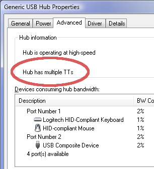

USB bandwidth is the main technical issue. With 30 Hz video, each Teensy gets 180 kbytes/sec, and if you play a 60 Hz progressive video, it’s 360 kbytes/sec. Teensy 3.0 can easily handle these speeds, because each runs completely separate, other than listening for the frame sync pulse. The main reason for the 1000 LEDs per Teensy guideline is so each board can easily accomplish its job with plenty of timing margin, even if there is some extra USB latency. If there is scheduling latency of other temporary software lag on the computer (eg, Java's garbage collection), and then it transmits one or more frames too rapidly, the timing margin greatly improves the whole system's robustness. The USB bandwidth plus timing margin is main reason for the 1000 LEDs per Teensy guideline. In theory, you might be able to connect more than 1000 and maybe still be ok, but at $19 each compared to at least a couple hundred dollars for the LEDs, you really will not save much connecting more LEDs per Teensy. I personally test OctoWS2811 with 960 LEDs connected to each Teensy, so I highly recommend you follow the 1000 LEDs per Teensy guideline for best performance and compatibility.
Somewhere around 20 to 40 Teensys, the total data flow is going to become a substantial part of USB 2.0 bandwidth. You probably want to keep the total under half of USB’s capacity. You might need USB 3.0, or add extra USB 2.0 cards. Typically all the USB 2.0 ports on a computer share the same 480 Mbit/sec bandwidth.
You must use good quality USB hubs. Beware of single-TT USB HUBs. They will cause problems. Only Multi-TT hubs properly share bandwidth. A USB "TT" is the Transaction Translator (basically a buffer memory and some logic) which converts between USB speeds. Sadly, very few hubs actually say which type they are... the marketing is all based on size, shape & color. But there are indeed 2 types of USB hubs and it does make a dramatic difference for a system like this. You can check which type a HUB actually is with Linux's "lsusb -v" or Windows 7's device manager.
