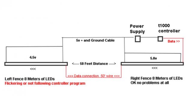

Here's my layout:
just under 8 meters of LEDs on Right Fence.
just under 8 meters of LEDs on Left Fence.
This is one single channel of LEDs across both fences for 1055 total pixels (33 LEDs under 16m total), controlled by the T1000s
Right and Left Fences are located on either side of the house garage so the fences are about 40' apart.
T1000s controller and power supply is located near Right Fence - The T1000s controller DO goes to the first LED DI of the Right Fence. It's about 20' of 16 gauge wire from the controller to the first LED of Right Fence.
Last LED DO of Right Fence is connected to first LED DI of Left Fence by 40 feet of 12 gauge copper wire.
Power and ground runs for Left Fence are 12 gauge and about 50 feet to power supply.
I am getting an effective 5.0 volts at the Right Fence and 4.3v to the Left Fence with all LEDS powered on (as measured at the LED strip connections)
Here is my grief. The data signal is flaky going to the Left Fence LEDs. The entire left fence will not follow the data programs consistently. For example, if I put on a static warm white program that I had programmed to 50% dim level, the Right Fence is flawless and the Left Fence will be correctly dim, then flicker brighter, then go back to proper dim, etc every few seconds or so. Same with color programs, it is like the LEDs get the data signal and then lose it, get it back, lose it etc. but only at the Left Fence. The Right Fence is operating perfectly up to the last LED where it jumps DO over to the Left Fence DI.
Gree has been helpful but there is a bit of a language barrier so you know how that goes. I have a suspicion that the issue lies with the WS2811 design and that it is not capable of pushing the DO signal from the last LED WS2811 chip of the Right Fence over 40' of 12 gauge to the first LED WS2811 chip of the Left Fence. Either that or there is excessive noise in the signal. Funny thing is that if I increase the voltage to Right Fence LEDs to say 5.2v, the problem goes away and left fence operates fine.
Gree said I should consider buying one of their TTL/SPI data receivers and install it on the Left Fence side of the 40' interconnecting data wire , but I'm not sure if that will work.

I'm thinking I may need to install a second T1000s controller and locate it near the Left Fence, but I'd really like to use a single controller. I don't think the issue is power voltage related since I can reduce the voltage of the Right Fence LEDs all the way down to 3.8 volts (using a DC-DC variable regulator) and it works fine with the data programs, it's just a bit dimmer (as expected). I had actually planned to run both fence LEDs at 4.3v using DC regulators (they'll never be running full bright anyway...these LEDs are BRIGHT!
Any help on what I could try to resolve the data issue is sincerely appreciated. Here is a crude drawing of my layout, and my new fences:
