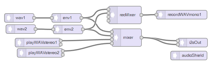

The example file uses both of these. It plays a C major scale while recording it, then seamlessly starts playback, stops recording a bit later, does the adjustHeaderInfo() magic, and keeps looping the playback. I've used two voice objects and two playback, so note starts overlap the release tails during recording, and playback restarts overlap the recorded release tails. Seems to work OK, but obviously this is "hot off the press" so quite likely to have some shortcomings.
Here's the example's design:
