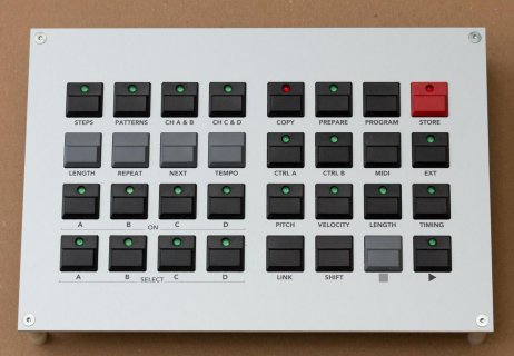

The button matrix can display and edit:
- Steps for four channels, the display next to the row will show the current pattern number
- Patterns for four channels, the display will show the number of repeats to go.
- Patterns & Steps for channels A & B
- Patterns & Steps for channels C & D
The button matrix is also used for data entry. For example, when the MIDI button on the control panel is pressed the matrix will display the current MIDI channel for four sequencer channels and MIDI channels can be selected by pressing on of the buttons in the matrix.
The 16 character display next to the tempo knob shows the MIDI channel alias name (instrument) for the selected channel and the tempo to one decimal place. A high resolution optical rotary encoder is used for setting the tempo. When the ‘CTRL A’ or ‘CTRL B’ parameter select button are pushed and held the display will show the selected controller and allow selection from a list using the rotary encoder. The selected controller definition contains the type (standard MIDI, NRPN, sysex), number, min/max values and MIDI channel.
All parameters can be adjusted while the sequencer is running, a special ‘prepare mode’ makes it possible to select patterns for editing without interrupting the pattern play order. Patterns can be chained by using the ‘repeat’ and ‘next’ properties, it’s possible to quickly create a chain by simply pressing the pattern buttons on the matrix. When the sequencer is running the ‘next’ can be overridden using the button matrix allowing switching between (chains of) patterns on the fly. Patterns, columns and rows (=channel) can also be copied and pasted while the sequencer is running.

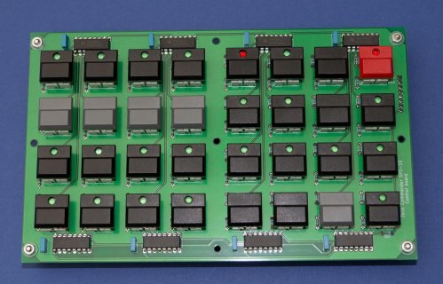

The C&K Digitast series switches have a very precise pressure point and tight feel to them, there no question wether or not you pushed them and they also don’t need a relay to make a nice clicking sound like with the Mackie control units. The bounce time of the switches is specified as less then 2.5ms. See this thread for the shift register story: 74HC165 shift register revisited.

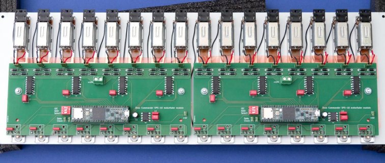

The faders are 100mm ALPS RSN type touch sensitive motorfaders. They are very fast, a 100ms full power burst will send them to the opposite side. Speed is important because we’re talking parameter recall here, switching fast between different parameters and patterns, waiting just half a second for the faders to settle would become annoying very quickly. I used full size 100mm faders to make it easier to set the pitch for as step, the range currently is 5 octaves form C0 to C5. The development of the motorfader control is described in this thread: Teensy controlled motorfader panel. The PID control still needs some tuning, during ‘link mode’ the faders following the master are sometimes ‘finding their spot’ and move a little but around. This doesn’t affect the operation because when in link mode the linked faders only act as displays, the actual values are set relative to the fader that is being moved.

The form follows function and used components. The faders shouldn’t be to close together and there should be a small gap between the step displays so the spacing is 1” (25.4mm). The spacing for control panel switches is a little less, 9/10”. The control panel switches are placed in two groups and different colours are used to make it easier to find the right switch without really looking. The important functions all have dedicated buttons, there’s a shift button for modifying behaviour but there’re no menu’s and no need for multiple clicks to access a function. The end result is a rather large device 69cm wide and 37cm deep. I didn’t try to make it smaller, I even added a palm rest (aluminum with birch ply cover because aluminium feels cold to the touch). It is what it is.

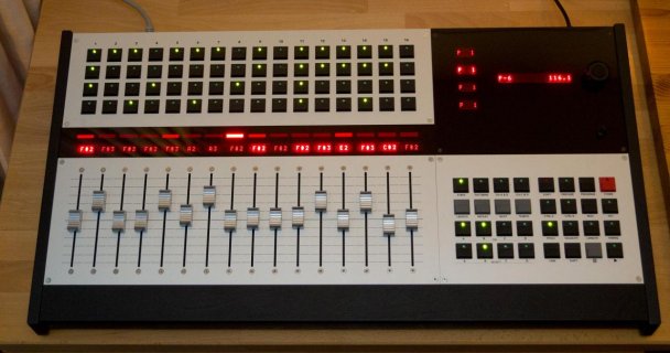

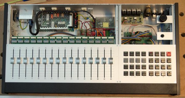

Picture of the build:

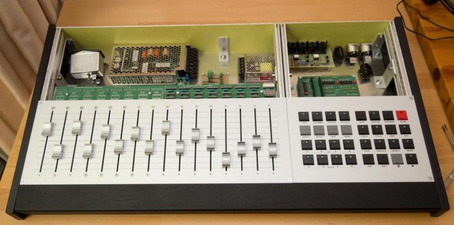

Control board with all components, completed control module, fader module with PCB’s.
Fitting components:

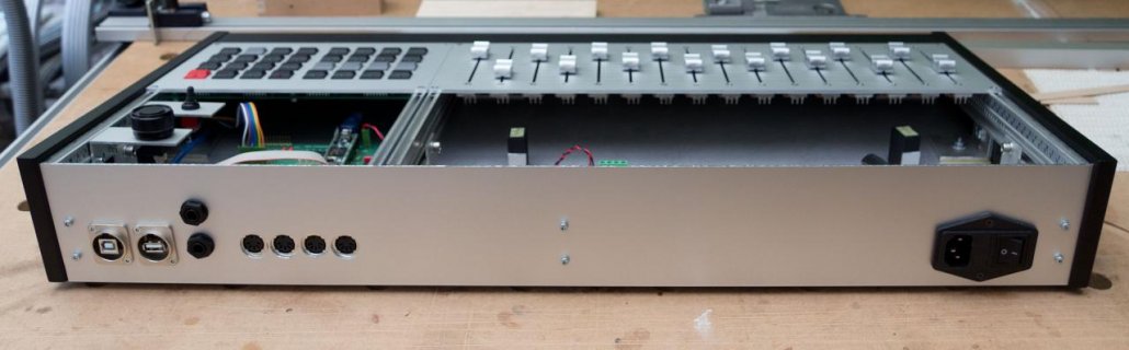

Rear view with power entry module and connectors in place:
Wired PSUs, fader panel, step displays and control panel operational.
The strip board with the two MIDI in / outs is from from earlier Arduino Due test project, I figured I might as well put it in just in case, it’s not connected yet. The two TRS jack and the USB host are also there for later use and not connected yet. The two DAC outputs of the Teensy are available on headers on the main board, I may use them for simple CV output (just modulation, not pitch).

For his project I learned to use KiCad and I designed the schematics and pcb layout for six pcb’s, this involved creating schematic symbols and pcb footprints of component like the Digitast switches and the ALPS motorfaders. I designed the front panels using the Schaeffer ‘Front Panel Designer’ to match the pcb layouts. The PCBs and frontpanels were fabricated and, lo and behold, everything fits and works
