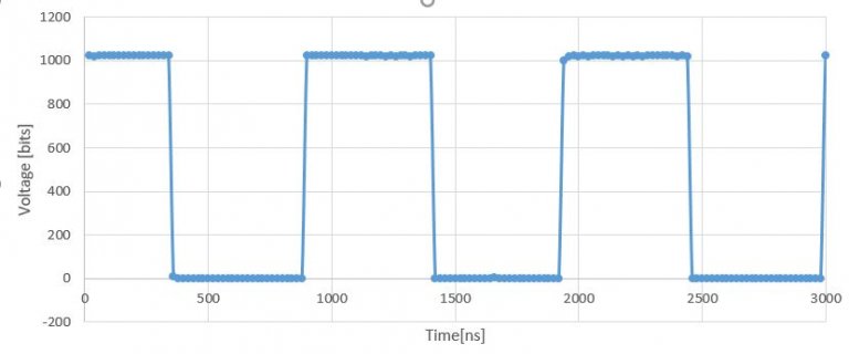

Following, reviewing the documentation in the pull requests, I finally came to the TeensyTimerTool. I used a Tick Timer and frankly works perfect
Thanks for your answer.
Find enclosed the solution code and a figure of the obtained resolution:

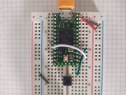

Nice work. What do you you have connected to interuptPin 18 and Pwmtrig 6? Can you show a picture of your setup or describe it?

Hi Maximiljan,
As simple as it may seem, it's just a push button that triggers the interrupt.

Hi, I'm taking nowadays 10000 samples at 20ns. I don't think that I'd be able to take 50000 at that sample rate. But, you can try to adjust the sample-rate. I recommend that you read the documentation of timers of the MCU and the about the library I'm using.
