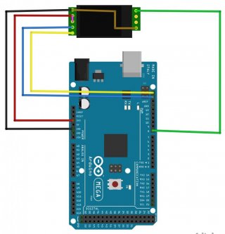

I have a "Senseair Sunrise" CO2 sensor and i got a reference code for that.
It works perfect an an arduino UNO with the following connections
I soldered the two connections on the sensor itself directly there. So just 5 wires go to the controller.
Then i connected the same sensor to a teensy 3.2:
Sensor -> Teensy:
GND -> GND (next to pin 0) (black)
VCC -> 3.3V (next to pin 23) (red) (Voltage is there. I checked it)
SCL -> SCL / pin19 (yellow) (i tripple checked it)
SDA -> SDA / Pin 18 (blue) (i tripple checked it)
Enable -> pin 8 (green) (same pin as the arduino)
I permanemtly get an error 4 for Wire.endTransmission(true);
I reduced the code to the minimum for analyses here
It still gives the same error:

I used no external resistors for pullup etc.
I tis confusing, because i used so many I2C devices without any trouble on teensys up to now.
Does anybody have an idea for solution or is further information needed?

The first thing I would do when I hooked it up would be to first see if the Wire scanner sketch sees this device or not. Examples->Wire->Scanner
If not found (or even if it was), I would try adding external Pull-up resistors. As unclear if they have any on both SCL/SDA
4 RxD/SDA1/0 Sensor UART receive input / 12 C bidirectional serial data; True Open-Drain when operating as output.
5 TxD/SCL1/0Sensor UART transmit output / 12 C clock input;True Open-Drain when operating as output, 100kO internal Pull-Up to VDDIO.
Error code 4 I believe is that the Teensy timed out waiting for it to become the master...

One of the documents referenced by Senseair says this:
Since Senseair Sunrise only provides a 100kΩ pull-up resistor on the SCL line an external pull-up resistor must be used for SDA. To be able to use data rates up to 100kbit it is in most cases suitable to use pull-up resistors in the range 5kΩ-15kΩ on both SCL and SDA.
You need pullups on both pins.
Pete
