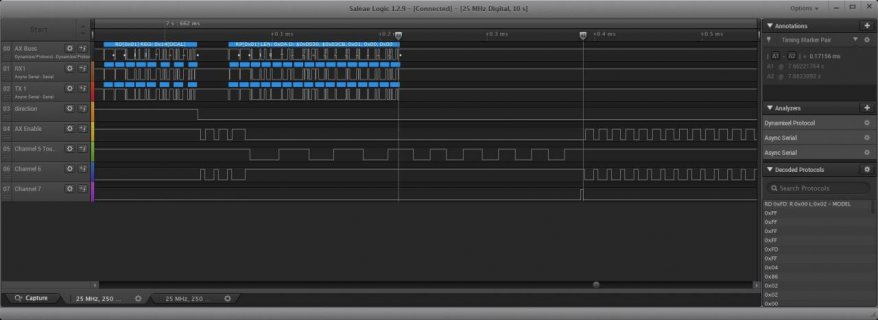

Maybe not too important, but was playing around with the Teensy 2 and I am playing with AX Buss code that runs at 1mbs.
I am running windows 10, 1.6.9...
Looking at output on Logic Analyzer I see there is gaps of time between bytes being output. Not sure if this shows it too well but:
So I took a look at: size_t HardwareSerial::write(uint8_t c)
in HardwareSerial.cpp and noticed the speed hack added to arduino in about 1.5.3 was not added here. The hack was when you call this function, if the queue is empty and the data register is empty, simply stuff it into the data register without adding it to queue and relying on interrupt handler. I found that this helped a lot at fast baud rates.

Was playing around some yesterday with T2 stuff, looks like if I am going to make my experiment work with turning the T2 into something like the USB2AX (atmega32u2, with lufa on visual studio... ), it will take additional changes to the Hardware Serial code to make it more compatible with Arduinos code base.
In particular, the settings in UCSR1B. My code base uses the UART in a half duplex mode without additional hardware. It does this by turning on/off the RX and TX parts of the UART. Works OK with Arduino core as the Serial1.write(...) only sets the UDRE0 bit and leaves the other bits alone.
Where Teensy core, Serial1.write(...) sets:
UCSR1B = (1<<RXEN1) | (1<<TXCIE1) | (1<<TXEN1) | (1<<RXCIE1) | (1<<UDRIE1);
So it just reenabled RX with RX interrupt. It does similar stuff in a few other places as well.
Will take a cut at changing this usage to match and see if that helps.
I went ahead and have made changes to my fork of cores, to add the bypass into Serial1 of the Teensy2 code. I also updated the code to change only specific bits of UCSR1B in the write and ISR functions, as to not necessarily enable the receiver which my user code externally updates to emulate half duplex. Again this makes it hopefully more compatible with arduino code base.
Paul: I also issued a pull request in case you wish to take a look
These changes did help speed up the output to AX Buss at 1mbs. Which you can see in the following screenshot:
In case anyone is interested, I am also trying to speed up the code to return the data from the AX Buss back to the host over USB. Using some other IO pins to trace things. If you see the green channel, this is in the loop when I receive a byte from Serial1 and then do a Serial.write(ch). I set high before the write and low after, and I see that it is taking quite a bit of time, so maybe not buffering?
So updated that code loop, to process through the input from AX Buss and buffer up and do 1 write at end, which appears to have sped things up here:
The green is now showing when bytes are put into queue, plus last one when I do the buffered write. The bottom channel, shows when I call Serial.flush() to hopefully make sure the data is sent to host...
Will play some more, plus maybe try out code using different host to see how speed is again versus USB2AX, plus see how much of the changes here in my sketch impact my code for T3.2.
