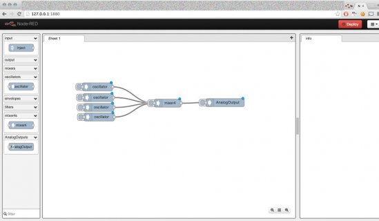

I am also thinking about a "visual-programming" interface for building projects using the teensy libraries (for me it would be more
audio library oriented).
here is a draft.

Puredata (http://puredata.info/) can do a lot. in fact, the beat detector I am working on, was already build in PD. If there is a possibility to convert from PD to a Teensy(arduino ) compatible file(library) I would be very happy..
regards
rob
This looks really awesome!
I've dreamed of doing this, but always considered it far beyond my limited time and GUI programming effort.
Is this available on github or a web page somewhere? I'd love to give it a try.
Puredata was initially much of my inspiration for the connection-oriented design of this library.
In the very early days, pretty much the May to December 2013, I struggled with how to structure this library to make best use of the Cortex-M4 hardware efficiently, yet provide a highly flexible model like Pd.
Puredata has 2 types of connections, represented with thin and thick lines. The audio library connections only correspond to the thick lines, which transport actual audio data. The thin lines in Pd, for events and numerical values (usually associated with configuring something) are done by the Arduino sketch calling functions from each object.
The other key difference is data types. Like Pd, the audio library tries to use floating point for parameters you change with the functions. But the audio data is 16 bit integers, because the Cortex-M4 has special DSP instructions for 16 bit ints. Unfortunately, this means the audio library will never be able to very fluidly mix control data and audio data like Pd can. It also means the object tend to have only higher level functionality, whereas Puredata lets you mix high level objects with very low level mathematical operators and other stuff. I recently added queue objects to get at the raw data from Arduino sketches, but they're a far cry from the amazing ways you can mix real time signals and math operators in Pd.
Eventually, when I get more time to really work on the Audio library, I'm going to add more objects that take a control stream as input. We already have a FM sine wave. A signal controlled filter and other stuff, and more synth objects to create ramps and other useful control signals, will be on my todo list. A Cortex-M4 isn't ever going to give you all the awesome flexibility Pd can running on a multi-GHz PC, but hopefully a set of objects with control signal inputs can provide a pretty useful subset.
I'm really interested to try Syso2342's GUI program. Long-term, I think it could really help people to understand and more easily build the object instances to copy into their Arduino sketches. I'd also like to use screenshots of the objects in the library documentation. It's really a piece of this system I never imagined I'd be able to create, so just seeing that screenshot has me really excited.
