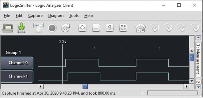

I've been doing some code optimization using GPIO ports on the T.36, for some reason I'm having troubles with GPIOB that I'm not seeing on other ports.
Why doesn't this second equation work equally to the first (which does work)?
example 1 works.
GPIOB_PSOR = ((i & 0x40)    << 12);
GPIOB_PSOR = ((i & 0x80)    << 12);
example 2 doesn't.
GPIOB_PSOR = ((i & 0xC0)    << 12);
its the same port and the same shift, so i should be able to combine the two. Works well on other ports, not GPIOB. Any thoughts?

I was not able to duplicate your problem. Both ways always set both pins. I first set and cleared the bits individually, then set and cleared them together.
Here is my code:
pinMode (29, OUTPUT);
pinMode (30, OUTPUT);
uint32_t i = 0xFFFFFFFF;
while (1)
  delayMicroseconds (1);
  GPIOB_PCOR = ((i & 0x40)    << 12);
  GPIOB_PCOR = ((i & 0x80)    << 12);
  GPIOB_PCOR = ((i & 0xC0)    << 12);
  delay (1000);
I switched over to PDOR and haven’t experienced the same issues.
I will revisit this again, but given that I can write and clear bits in one operation with PDOR, it turns out to be more efficient vs PSOR + PCOR.

Think my issue could be related to setting optimize to "Fastest with LTO" in arduino IDE. When i switch it to "Faster with LTO", the corruption goes away...
I did a test, recompiling both ways. Either it's problematic with GPIO port commands, or just the way I'm coding it has to be phrased a differnet way to play nice...

I tried my example above compiled with "Fastest with LTO" at speeds up to 240 MHz and it worked every time. It may be a subtle timing issue with your setup - what defines 'not working'.

I suspect you’re right. I think maybe the code is “too fast” in some situations for the memory I’m controlling.
I’m going to try and program in some delay (without using the delay()) and see if that helps. The memory wants specific timing once an address line is written before it’s ready to read the data, maybe 70ns.
Since delayMicroseconds() is too slow (1us min), I was just going to wing it using a while or for loop and experiment with the count max. Unless someone has built a delayNanoseconds() libray...
If a pin is not assigned to GPIO via the MUX (by calling pinMode (x, OUTPUT)), then the value in GPIO_PDOR does not affect the pin.
Teensy 4 has a delayNanoseconds(), but not Teensy 3.
This line has about 40 nanosecond overhead plus 40 nanosecond delay per loop at 240 MHz (80 nanoseconds at 120 MHz):
for (int volatile index = 0; index < 1; index++);
So 40 nanoseconds for 0, 80 for 1, 120 for 2, 160 for 3, etc.
Bullseye!
I plugged that in before i read the datalines and BINGO. It adds about 0.8% more CPU overhead (vs without delay), but allows me to compile using Fastest With LTO.
