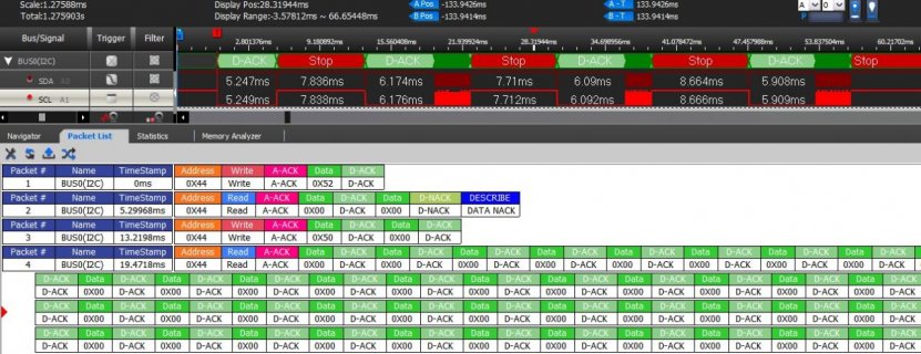

I have a project which has a PC-side program issuing commands over a virtual COM port to a Teensy3 (handled by Serial on the device side). The commands trigger some I2C activity, and return a byte of data indicating error status (Slave not responding, and such). On the PC-side it will send a command, await the error byte, then immediately send the next command. There are no delays on the PC-side other than presumably some OS scheduling for USB traffic.
I noticed on my device that the commands are slower than expected, and each command appears to have ~100ms delay between it. I'm trying to locate the source of these 100ms delays. Here is an example picture of what I'm seeing - it is a series of commands, you can see that each burst of I2C activity is separated from the rest by anywhere from 102ms to 115ms:
My guess is that this is due to the USB traffic. I've done some low-level USB work before, and I know some devices can have descriptors set to indicate a polling rate, but I've not pulled apart the Serial code to figure out what is going on.
Is Serial the problem here? and if so is there anything I can tweak to modify this behavior?

You nailed it. Sorry for wasting your time here, this is my fault actually. A long time ago I was working on a project that had a latency between commands, and on a write command followed by a read, the PC-side code would invariably attempt to read before data was present - since the read routine was non-blocking I put an arbitrary delay (cough *100ms*), then retry wrapper on the read routine.
I fixed it and get this now:

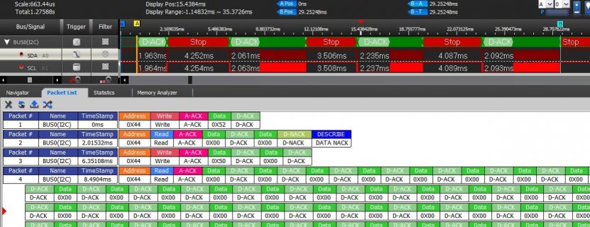

I looked through your latency test code. I like the brevity of it, simple and effective. I pulled the comm lib I was using out and recoded routines based on your latency test code (I like the way it can work for all platforms too, nice!).
The result is a good improvement, now it's down to 5-9ms between commands. I'm keeping this one I think:

Hah, thanks for that tip. I put some send_now() functions into the Teensy side and now it's even better: 2-4ms between commands!
Thanks for all the help, this is a huge improvement :)
