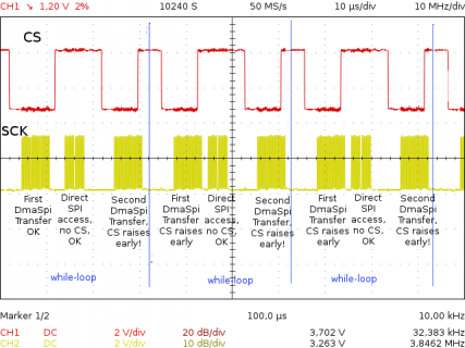

Hm....that will take some time to figure out. When I tried the current DMA SPI implementation with SDFatlib, it worked well. If it had screwed up my DMA transfers, I would see garbage on my display.
Can you elaborate a bit more on your scope picture? I'm having difficulties figuring out what's (not) happening when.
Christoph,
I have decorated the image a bit. Please pay attention to the timing relationship between the end of the yellow clock cycles and the rising edge on the CS line.
As CS is handled entirely in software, I omitted changing the line during the direct SPI register access.
The first DmaSpi transfer (3 bytes) works fine and CS is raised about 1 us after the last clock cycle. Then the software switches to direct SPI access and outputs two bytes directly to the emulated SPDR (which comes down to SPI0_PUSHR) and waits for each byte to be shifted out completely. There is no CS handling for that.
Then we have the second DmaSpi transfer, which again outputs three bytes. However, CS raises roughly 1us BEFORE the end of the transfer. Also note that the gap between the DmaSpi transfer and the direct transfer decreases, as the ISR is called earlier and marks the SPI object as idle.
The while loop ends and the three transfers repeat, however, CS always raises early.

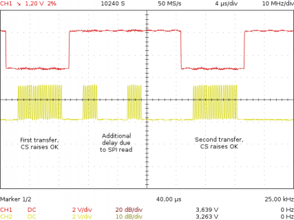

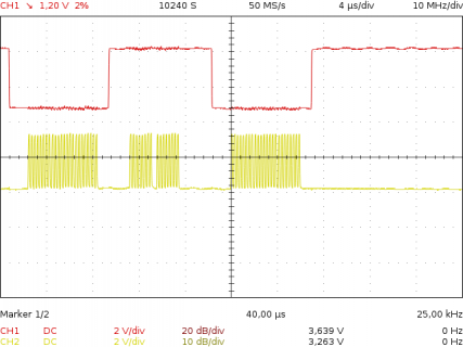

Unfortunately, I don't have a scope, so I'll have to use yours for this:
What happens if you don't use the emulated AVR SPI between DMA transfers, but still pause(), release() and resume()? As in:
while (1)
    uint8_t data[]={0xf0, 0xa5, 0x03, 0xcc};
    DmaSpi0::Transfer trx(data,3,nullptr,0,&ethCs);
    DMASPI0.registerTransfer(trx);
    while (trx.busy());
    DMASPI0.pause();
    while(!DMASPI0.paused());
    DMASPI0.releaseSpi();
//    SPDR=0x0;
//    while(!(SPSR&(1<<SPIF)));
//    SPDR=0x0;
    DMASPI0.resume();
    while (trx.busy());
Do you still get an early deassertion of the CS line?
Regards
Christoph
Christoph,
without writing to SPDR, everything works fine:
You should be able to reproduce the behavior with any SPI device that relies on a valid CS until the end of the transfer. I ran into this problem with an ENC28J60 (Ethernet chip) that stopped responding after I switched to direct SPI mode.

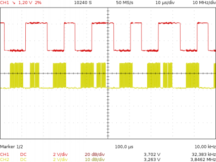

Found it!
Things started working after I added another DMASPI0.begin() into the loop. I then stripped it down line by line and found that the magic command that made everything working was
SPI0_MCR = SPI_MCR_MSTR | SPI_MCR_DCONF(0) | SPI_MCR_CLR_TXF | SPI_MCR_CLR_RXF;
Taking a closer look, it was resetting the SPI_MCR_CLR_RXF bit. that made the difference. And it explains why you couldn't reproduce the problem: As I wrote to SPI0_PUSHR, but didn't read the result from SPI0_POPR, the byte read during the cycle remained in the FIFO and generated an additional SPI DMA request as soon as a DmaSpi transfer started. Reading SPI0_POPR after the transfer also eliminates the problem:

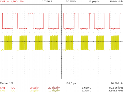

Without reading SPI_POPR, we must make sure to clear the receive FIFO before starting a new DMA transfer:
    uint8_t data[]={0xf0, 0xa5, 0x03};
    DmaSpi0::Transfer trx(data,3,nullptr,0,&cs);
    while (trx.busy());
    DMASPI0.pause();
    uint32_t mcr = SPI0_MCR;
    SPI0_MCR = mcr | SPI_MCR_MDIS | SPI_MCR_HALT;
    SPI0_MCR = mcr;
    SPDR=0xF;
    SPDR=0xFA;
    mcr = SPI0_MCR;
    SPI0_MCR = mcr | SPI_MCR_MDIS | SPI_MCR_HALT | SPI_MCR_CLR_TXF | SPI_MCR_CLR_RXF;
    DMASPI0.resume();
    SPI0_MCR = mcr;
    while (trx.busy());
With these changes, DmaSpi works like a charm. Can you update your code on GitHub, please?
