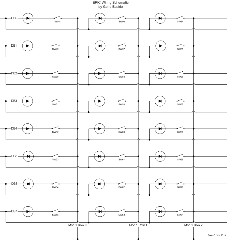

    Hi there
    I'm a complete electronic dunce, trying to learn and create a lighting control board that will run using HID over the usb link. So 6 axis, 17 sliders and 128 buttons is just what I'm looking for.
    My biggest problem is building the connections between the sliders, axis, buttons and the teensy3 board.
    The board posted here only has 33 buttons and 14 sliders on it (I assume the 6 axis is accessed via the pins on the edge of the board).
    I assume the buttons uses a mapping matrix that requires the 2 parts of the switch to connect to a number of shared lines (36 runs via 12 channels 6 rows and 6 columns). So 128 buttons would work how and be connected to the Teensy how?
    Any suggestions on where to start would be appreciated.

    Ok so some more digging has me thinking. Let's start with my goal. It is based on the above post re a joystick of 128x1bit (buttons) and 48x8bit (sliders/axis etc) to build a control system for lighting control software (QLC+).
    So as a noob I was confused about the pin descriptions of the teensy, until I read the USB-midi page. It includes a circuit diagram to connect many 74HC4051 integrated circuits to handle lots of buttons and sliders. Buttons going to a digital pin and sliders going to an analog pin. One has to use 3 digital pins that connect to all the 74HC4051 (a "bus" of some sort?) and then each of them additionally occupies either a digital or a analog pin on the teensy.
    I was already aware of the button matrix method (from the BU0836A). So my first question now is this: If we use the row/column button matrix, then a 8x8 button pad (8 rows and 8 columns) would use 2 of 74HC4051 chips? They both have 8 channels and the matrix works on detecting which rows and which columns have been switched so that will work? The issue then becomes to write the software to read the signals on the eight columns an rows and interpret that to find out which buttons have been pressed. and then in turn to send this through to the HID packet.
    My second question relates to the other pieces of hardware. For my goal, I do not need LED's, maybe later but not now. I also need just a signal that a button has been pressed (momentary on), so there is no latching logic required - again maybe later but not now. My initial build will probably be two 8x8 button matrices made of B3F square switches. Now the question is this: Apart from serial diodes, what other electronics needs to be fitted to the button circuit to make it work with the 74HC4051 chips?
    The same question relates to the sliders. There will be 48 potentiometers (5k ohm, I guess) that each connects to 1 pin on the 74HC4051 , which in turn uses 1 analogue pin on the teensy and share the same 3 digital pins with the 74HC4051 used for the switches. What other circuit components are needed to make this work?
    The USB-midi example seems to suggest: none!
    So my joystick plan is this:
    1. Buttons on an 8x8 keypad (with serial diodes) made in the configuration of 8 rows by 8 columns and each row and column mapping to a channel on a 74HC4051. For 128 buttons that would be four 74HC4051 chips using 3 (common) teensy digital pins plus 4 additional digital pins.
    2. Sliders have one leg linked to a channel on the 74HC4051. So for 48 sliders that gives me six 74HC4051 chips, using the same 3 common chips as the buttons plus 6 more analog chips.
    3. Teensy software to read and calculate button states and set the appropriate bits in the HID packet. The same software should read the values from the faders and convert it to 8 bits. This software is also a grey area to me. I'm hoping some the Teensy guru's will help here.
    4. Teensy software to create the appropriate HID headers etc to make it readable by the lighting controller software.
    If I can build a 128 button 48 fader joystick to run my lights, it would be fantastic!! This is exciting.
    Please advise this (an hopefully future) noob(s).

    stevos758, if the board uses a "typical" row & column matrix, this should work:
    I drew that up about 14 years ago (wow!) to help explain how switch matrices could be wired up to the R&R Electronics EPIC controller. Think of the "DBx" labels as "Row x" and the "Mod x, Row y" labels as "Column x"
    It wouldn't take much work to convert that to a little PCB that could support row & column terminal blocks with the diodes stand on end between them.
    Here's another question - with the Teensy 3.1 configured as this "mega" joystick, would it still be possible to communicate with it? I ask because it would be nice to be able to write a configuration tool that would allow you to reverse axes, tweak dead zones, adjust response curves, etc.
    g.
    g.
    Thanks for the Pro-Tip! I plan on making the matrix PCB with my CNC. I just need to know what pins to hook it up too. I actually don't need all of the buttons and axis. Just more buttons than the stock teensy.
