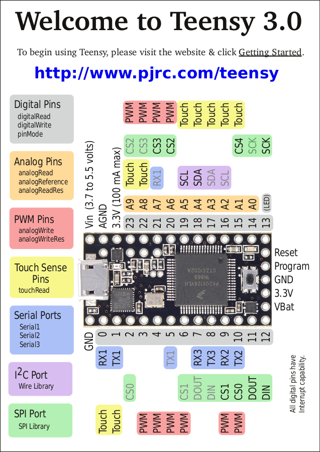

    On these nice little Teensy 3.0 cards there is actually a second SPI bus visible where the ports are written in grey. But I don't know how to use them:
    There is only one SPI bus - see Chapter 43 of the manual. The chip has a multiplexer which allows you to reassign inputs/outputs to different pins - see Chapter 10. For example, the SPI SCK signal is normally on T3 pin13 but it can be reassigned to pin14 - I've done it (with help from Paul). See http://forum.pjrc.com/threads/431-Re...-%28SPI-SCK%29
    So you could reassign the bus DOUT/DIN signals from pins 11/12 to pins 7/8 but it isn't a different bus.

    THT, this picture is the old, wrong one (I know it's on the KS front page, but Paul explained that he can't change anything there after the ks was finished.
    this is the one you get with your teensy :
  8. #8
