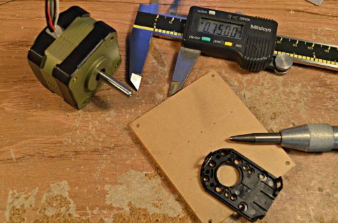

In this context, real world means attach the encoder to the output shaft. Mark the output shaft and the encoder support. Run the motor 1000 turns in increments of one turn. Visually measure the mark at the end of each turn. If the marks don't match up, there is a problem.
First step - center punched and ready to drill.
They sure don't allow much tolerance for the hole positioning on that encoder mounting bracket using 4-40 screws. I'm going to thread the holes for the screws mounting the encoder, but oversize the 2 holes holding the stepper motor to allow a little tolerance in my drilling and still (hopefully) keep these shafts aligned well.
Just use double-sided adhesive mounting squares to mount the encoder. This works fine for testing.
Fully built.....

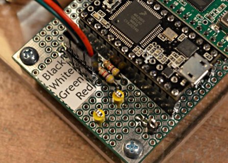

I am only concerned about what you have between the Teensy 3 and the encoder. It is unclear from the photo what you have where. Where does the 470ohm resistor(s?) come into play? Can you diagram, please. Thanks.

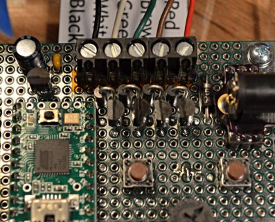

The 2N2222, 1N5817 and 470 ohm resistors are used to connect the stepper motor to the Teensy2.
For the encoder, VCC connects to VIN, ground connects to GND, "A" connects through a 4.7K resistor to pin 5 and "B" connects through a 4.7K resistor to pin 6.
Actually, I wired A's resistor to pins 3 and 5, and B's resistor to pins 4 and 6, in anticipation of someday testing on those other 2 pins. But for this test, 3 and 4 were unused.
If this description isn't enough, I could take a couple close-up photos. I'm afraid that's about all I can do. I've already spent quite a lot of time on this. I have several other urgent tasks demanding my attention, so I just can't keep pouring more time into this.

470 ohm resistors are used (together with transistors and diodes) to connect the stepper motor to the Teensy2.
For the encoder, "A" connects through a 4.7K resistor to pin 5 and "B" connects through a 4.7K resistor to pin 6, on Teensy3.

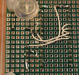

Here are close up photos. As usual, click for the full size.
Here's the encoder circuit.
The ground connections are made by soldering a wire nearby to the ground plane on the top of the board.
The A and B signals connect to those 2 resistors, which are 4.7K.
The resistors connect to pins 3+5 and 4+6.
The power is connected to VIN (5 volts from the USB). That little green part is a 100 mA PTC fuse. I also soldered a 4.7 uF capacitor from the power pin to ground. I'm pretty sure the encoder will work without the capacitor, and the fuse is just an extra precaution I took.

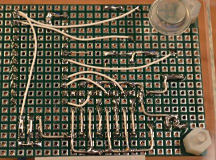

Here's the stepper motor connections. The motor connects only to the Teensy2 board. It's totally separate from the Teensy3 reading the encoder.
In this bottom side photo, you can see the four 470 ohm resistors. They're soldered at each transistor's base pin, and the other side connects to an I/O on Teensy2. The 4 emitters connect to a wire that goes to ground, and the 4 collectors connect to the large diode wires, which bend over and go right to the terminal block. You can see I bent the cathode side of each diode to go between the terminal block pins, where they all connect to +12V.
There's actually 1 more diode between the input power and everything the motor and diodes. That's to protect against accidental reverse polarity.
The other part that looks like a transistor is a LP2950 voltage regulator. It creates 5 volts for the Teensy2, so the motor stuff can work only from the 12V power, without USB connected.
