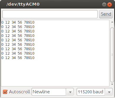

    About Serial.printf.I get the following error:
    /home/user123/arduino-1.0.5/hardware/tools/arm-none-eabi/bin/../lib/gcc/arm-none-eabi/4.7.2/../../../../arm-none-eabi/bin/ld: section .progmem.data loaded at [000000000000a15c,000000000000a16d] overlaps section .data loaded at [000000000000a15c,000000000000a78b]
    collect2: error: ld returned 1 exit status
  6. #6

    Can you please post the code that reproduces this error? I can't do anything if I can't reproduce the problem.

    Sorry. I thought it was a known issue or something like that:
    Serial.printf("%d %d %d %d %u\r\n",header.from_node,payload.id,payload.comman d,payload.pin,payload.data);
    payload and header are structs like:
    struct payload_t
    byte id;
    byte command; //read, write, set digital, set analog
    byte pin; //pin number
    unsigned int data;
    removing that line makes the rest of the code work. It's long, and closed source.

    If you want me to investigate, you must post a complete program that I can copy into Arduino to reproduce the problem. I don't need to see your entire proprietary application, but I do need you to copy just the part that crashes into a small but complete program that reproduces the problem.
  9. #9
    Join Date
    Nov 2012
    Posts
    24,101
    Here is a perfect example of why I insist people post a complete program that is reproduces a problem!
    I copied the struct definition and printf line into a small test program. I filled in the missing parts, substituting zero for the first variable since I have no idea what "header.from_node" is. Since it's referenced by "%d", I assumed at integer. (if this isn't actually an integer, it very well may be the cause of the problems you're seeing)
    Here is the code I tested:
    struct payload_t
      byte id;
      unsigned int data;
    payload_t test;
      test.id = 12;
      test.command = 34;
      test.pin = 56;
      test.data = 78910;
        0, test.id, test.command, test.pin, test.data);
    As you can see in this screenshot, I was not able to reproduce the problem.
    Normally when people post these bug reports without a complete program, I don't do this work to turn them into a complete program for testing. It pretty much always ends up this way.
    I'm not denying there may indeed be a bug. I really do want to investigate and fix any bugs. But until you post a complete program that reproduces the problem, what am I supposed to do?
