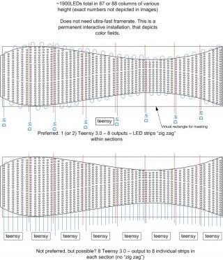

I am working with an artist on a large interactive LED wall that is shaped like a waving ribbon. Hard to describe, but imagine a long strip where the top and bottom surfaces are like sine waves.
WS2811 strips are arranged vertically along the length of the ribbon, in approximately 87 columns on 4" centers. The sine waves are not "in sync", so the result is non-uniform heights (or, between 18 and 35 LEDs, depending on where in the strip you are).
Attempting to use an Arduino Mega at first, the refresh rate is far too slow to fill out the entire array, so I've moved on to Teensy.
My question is that considering how OCTO is designed for roughly rectangular displays, what is my best approach to achieving a coherent graphic display, for example, using movie2serial, with the ribbon shape effectively cropping the video?
If think of the display as a really tall rectangle on its side, with height = 80 and width = 35, then if I use a single Teensy, with 10 columns zig-zagging left to right top to bottom, the image is lost because the strips are not uniform.
Unless there is a way to define the pixel locations outside of a rectangular configuration, is my best bet to just get enough Teensys to run every single strip independently (87 strips)? This isn't out of the question, as I don't care about the cost, but seems like 8 or 9 USB connections may be problematic.

I would think of the screen just as you have (an 80 x 35) rectangle, but with a "mask" of sorts. Separate your visual coordinate system from actual teensy pixel index either by logically shifting things or with a predefined lookup array. An example of the former is already done in some of Paul's code to handle things like the serpentine pixel layout.
My setup is rectangular, but has a big chunk cut out of one side and hole in the middle. This kills any ability to use the built-in layouts (especially with long strips that double back on themselves a few times). So I ended up building a map
From your description, I picture something like this (only sideways).

I will be playing with this today, and I think the masking/mapping approach is what I'm looking for. I think you both understood what I'm doing here, but the image below depicts the rough shape of the panel (it's 30 feet wide) and the two approaches I was thinking. The first one, with one or two Teensys and some image masking/mapping option is preferred, though I did just order and overnight 8 Teensys just in case I have to go with option two. Not sure how that many USB cords running around is going to work.
It will be some tedious work to map out the mask, but it only has to be done once!

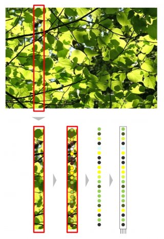

If I understand correctly, the solution proposed by Paul is to "sample" the source image (which is always the same resolution, by the way) by creating multiple vertical narrow copy regions, each corresponding to one LED column in the physical display.
This is actually exactly how we originally envisioned the concept - see image below: my concept approach

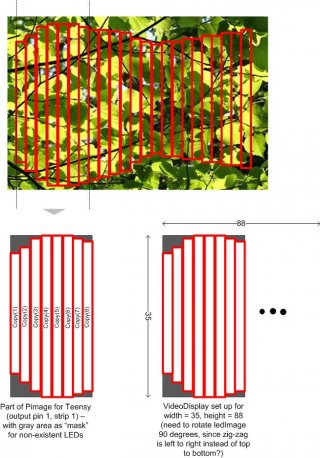

My question is: for this approach each copy call becomes what is sent to one individual Teensy, right? So, if I have 87 copy calls, one for each column, then wouldn't I actually need an unwieldy 87 Teensys? Or, is there a way to bundle 8 copy calls and send them to each of the 8 outputs on the Teensy (still requiring 10 total for the display)?
I think creating the virtual pixel map tetsuo recommended, while not the most efficient due to processing and pumping out nonexistent pixels, may be easier on the wiring.
No. Please look at the movie2serial source code while reading this answer. You really *must* look at the source code to understand this. Reading only this message probably won't make sense.
The copy() happens inside a loop:
  for (int i=0; i < numPorts; i++) {
The "numPorts" variable is the number of Teensy boards you've connected. The loop runs for each Teensy. The copy command builds the image for each Teensy.
Sure. Inside the loop, you can compose each image any way you like. If each Teensy needs different code, you might do something like:

There's also no restrictions like having to do a copy for each physical strip. You've got a large Pimage representing the current video frame and you're copying pieces of it into the image sent to each Teensy. It's just pixels. You can copy them, or generate them any way you want. There's no restrictions on which copies target what. You can use as many or as few copies for each ledImage[].
Right after you compose pixels into "ledImage" (notice the array syntax... there is a Pimage for each Teensy3), the code immediately after that does some translations to turn it into OctoWS2811's raw data format, and then it's transmitted.
You can use any number of Teensy3s, and with proper programming, you can put whatever pixels you want into each of them. This project is physically large, but it's under 1000 LEDs, so it's relatively small for Teensy3. Using a small group probably makes the signal wiring easier, but you could run the whole thing with a single Teensy3.

As it stands, and based on your clarifications on the copy action in creating the LedImage, I will copy() narrow/tall rectangles out of the source with an arrangement matching the physical display as close as it can. Then, I will construct the PImage that gets processed and sent out to the Teensy. My concern with constructing the PImage from a number of non-uniform-height rectangles is that I can't have a non-rectangular PImage! So, if I reconstruct the rectangle arrangement within the destination PImage, pretending my physical LED array was fully rectangular, then when I send it out to the Teensys, the areas of the PImages with interesting content will be what I sampled from the source, and the nonexistent LEDs will be occupied with the filler space from the contstructed PImage.
