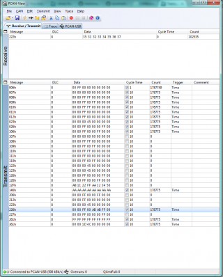

this is what i get from the canbus:

this is the pcan screenshot
You are not setting the message length when sending from the second Teensy, so (buf[0] == 49) will always be false.
I put the length on the second Teensy but still not working, because the program on the frist Teensy never passes the " if(myCAN.available()) " , for some reason myCAN.available() always return a 0. I checked the bus in a Osciloscope and theres data on it, but i can't make the comunication.
it may sound silly but when i can't initialize the bus normally the bus itself is not ok, missing terminators or pairs not twisted or ground levels too different, the other issue could be that the teensy can't initialize an empty bus therfore i would suggest to connect before another CAN hardware like a pcan dongle.
i'm using the flexcan with teensy and a pcan dongle and everything is ok.
Cheers.
Cheers.
I'll check it today to see what's what, but is really important to have twisted wires or pairs?
Twisted pairs i not that importan unless you work beside a nuclear fusion reactor :) or if you lines are gettin very long.
Just check wires ad termination resistors (1 on 20cm short wires at 500kbit/s is enough), by spec you need 2, by mistake i got a car canbus working fine with 3 resistors.
you line should be like:
+----CAN-H----+
R             R
+----CAN-L----+
If all is ok then you should have a look to the transcivers one may be dead.

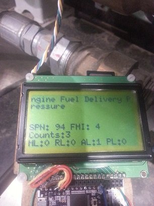

Awesome work on this.
Using some of your notes on CANBus I am reading and writing to a medium speed can in a Ford vehicle and beginning to make a library of the body functions on that bus. I have one issue that I am hoping someone can help with. Much of the information broadcasting on that bus occurs at set intervals - typically every second. 2 in particular I would like to intercept and then write my preferred frame back. Because of the nature of that bus, it has thousands of frames on it in just a couple of seconds. I am successful at suppressing the message I want to block by flooding the bus, but I would much rather intercept it as it occurs using a switch.
My current sketch to intercept with a switch reads each incoming frame and looks for 2 can IDs. It can keep the native signal suppressed around 90% of the time, but the message being sent from the vehicle controller will get through for just long enough to flash on the indicator before being suppressed again - due to the FI FO nature of the bus I suspect. Is there a better method to intercept and block it - possibly by defining a priority so that the writing of the frame is not waiting on the bus to clear to transmit?
In order for my flood suppression to work (without using a switch to catch it), I have to pass my frame in at 5 times the rate as it normally occurs. I have concerns about keeping the bus flooded with that traffic.

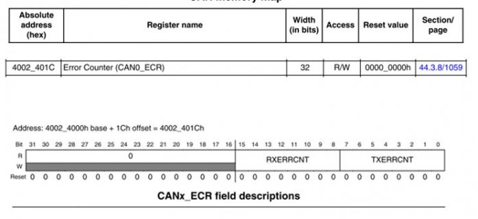

Hey all!
I'm having issues sending as well (saw Foyds problems). From my analysis of the TRM of CAN and reviewing the driver it seems as if the message buffers aren't being emptied (TX process isn't starting due to arbitration nothing working). I added some debug messages to the driver to figure out what's going on:
This is UART Log Task 54
starting can tx
found buffer
sending message
starting can tx
found buffer
sending message
starting can tx
no buffers :(
starting can tx
no buffers :(
starting can tx
no buffers :(
starting can tx
no buffers :(

I didn't have it hooked up to a transceiver (TxR) first just to see if it was sending bits, it wasn't so I figured the arbitration wasn't starting due to missing TxR. I've designed CAN communications systems before but never wrote the software for it but I have knowledge of uC intereworkings.
I've attempted this with just the example and I've tried it with some modifications and using FreeRTOS implementation. It gets into the driver, the driver setups the message buffer but the hardware never sends.

To have a functionibg CAN bus, you do need at least two nodes ... the transmitter needs an Ack from the receivers. It is not clear to me thst you have that. Some examples use loop back or two channels to avhieve that.
I have a CAN analyser but no I don't have anything to ACK but the modules has to SEND something for me it ACK. I also have a logic analyser on the pins and NOTHING comes out of them. I would expect some sort of BUS activity. I do notice that Freeze ACK is always on and I cannot get it to turn off and all my buffers are stuck in CODE = 0xC.
Finally made it, it was the filters that I havent defined it on my code so the teensy assigned them some stuff.
Hi;
Just want to add something for anyone else interested in j1939. Teachop's Flex can works well for the extended ID and j1939. I have a very rough code reader that has been tested on some industrial engines, QSK 50, QSK 45, and some smaller tractor engines too. Once the code is in a less embarrassing state I will post it.
here is a snippet of code for anyone trying to decode j1939 error codes with the flexcan library:
sourceAddress = rxmsg.id & 0x000000ff; // mask out 2 byte source address
PGN = (messageID & 0x3FFFF00) >> 8 ; // mask out 19 bit PGN and shift
  if (PGN == 65226) // PGN for active codes
//________________________SPN
  SPN = (data5 & B11100000) << 16; // clear first 5 bits && move to correct MSB
  SPN =  SPN + (data4 << 8);    // add second byte and move to correct position
  SPN = SPN  + data3;         // add third byte LSB
  //________________________Fault Mode Indicator
  FMI = data5 & B00011111; // clear first 5 bits
  //________________________occurance count
  OC = data6 & B01111111; // clear first 5 bits
  //________________________malfunction lamp
  malfunctionLamp = (data1 & B11000000) >> 6; // use bits 1-2
  //________________________red stop lamp
  redLamp = (data1 & B00110000)  >> 4; // use bits 3-4
  //________________________amber warning lamp
  yelLamp = (data1 & B00001100) >> 2; // use bits 5-6
  //________________________protect lamp
  protectLamp = data1 & B00000011; // use bits 7-8
Hello.
I have a small project that I am working on, that is using the FlexCAN Library. All is working great! Thanks to all those that have contributed.
For the purpose of background checking I would like my code to periodically read the CAN ‘TX & RX’ Error Counter registers that I can see listed in the Freescale Reference Manual.
I may only use these values during development, but having access to them during run-time would be great for picking out bad hardware etc
From the Freescale Reference Manual pages 1046 and 1060 (as per the image below)
The Register Error Counter (CAN0_ECR) contains 2 x 8 bit counters that reflect the Transmit and Receive Error counters.
I can see that the FlexCAN Library has provision for this register; specifically it is listed in the file (kinetis_flexcan.h) as follows:
#define FLEXCAN0_ECR (*(vuint32_t*)(FLEXCAN0_BASE+0x1C))
Using the FlexCAN Library, this register decodes to the 0x4002401C address.
The library also lists a second Error counter:
#define FLEXCAN1_ECR (*(vuint32_t*)(FLEXCAN1_BASE+0x1C))
Using the FlexCAN Library, The FLEXCAN1_ECR register decodes to the address 0x400A401C, but I am not sure if this is an error in the library as this register does not appear to exist in the Freescale Document? I could be overlooking something here though.
I have been attempting to extract the value of the above registers to use in my code, but with no success. Being honest I have hit knowledge/my coding skills wall.
Q) Does anyone know a way (or have a close example that I could follow) of how I could directly read an internal Register from the Teensy to use in my code?
Thanks guys!
Keith
