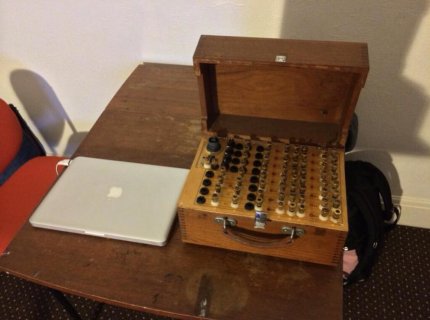

So I've got a Teensy 3.0 which I bought specifically for this USB-MIDI to Relay box I'm building.
Here's what the hardware itself looks like (all repurposed/vintage parts!):
The guts are set up such that when each relay receives 5v it fires.
So what I'm trying to do with the Teensy code is read MIDI note messages and set corresponding digital pins to HIGH.
I'm thinking of using MIDI notes 60-75 and digital pins 1-16, so pressing MIDI note 60 will set digital pin 1 HIGH, and releasing it would set it back to LOW.

Hi Krista
You can use the note parameter of the event handler function to determine which pin to set up
you can make a simple switch block like
switch(note){
case 60:
 digitalWrite(1,HIGH);
case 61:
 digitalWrite(2,HIGH);
 ... etc
and in the same manner for the noteOff with
digitalWrite LOW
maybe you would also want to check first if the channel is the specific one, so you don't trigger from any other accidental midi notes, and also that velocity is over 0(for note on)

haha ok maybe the second method would have saved you all the typing!
by the way you can also set the pinModes inside a loop to further make the code more compact
You have to first set the USB Type to "MIDI" under the Tools menu in your Arduino IDE.
PS: Teensy 3.0 is running on 3.3V so the highs of the digital pins will be below 5v!
It looks as if you are mostly set on the coding stage (and yes for a simple run of 16 digital outs, the computed pin number is much better:
if((note>=60)&&(note<=75)){
 int oPin=note-59;
 digitalWrite(oPin,HIGH);
Since you are using USB MIDI you don't need to check for the special velocity value of zero on NoteOn (USB MIDI does not use running status).
The next thing you will need is a way to drive the relays. You mentioned 5V - is that what the relays need? Teensy 3.x uses 3.3V, and most relays will need more current than a microcontroller can supply. Check out this article which explains using transistors from digital outputs to drive relays (its written from the point of view of a 5V micro driving 12V relays, but the principle is the same).
http://www.w9xt.com/page_microdesign_pt7_transistor_switching.html
Ah, I didn't see the 2nd bit when I first nabbed the code. That makes sense.
So for the noteOffs it would be the same but just set (oPin, LOW)?
The hardware part was built by someone else and uses transistors to drive the relays. I hadn't considered the 3.3v though so hopefully that isn't an issue.
