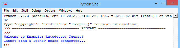

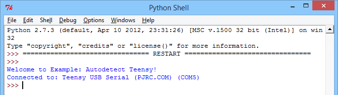

if __name__ == "__main__":
    print "Welcome to Example: Autodetect Teensy!"
    try:
        teensy = TeensySerial(115200)
        print "Connected to: %s" % teensy.teensy_port[1]
        teensy.close()
    except TypeError:
        print "Cannot find a Teensy board connected..."
Teensy not founded:
Teensy founded:
This code works on Windows but I don't know the effects in others Operational Systems... I'm not so good at programming, so... if you have suggestions/corrections feel free to interact. I'm glad this code can help you with your projects!
