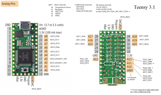

Pedvide, this works fantastic! I numbers I get from my log scale light sensor are much more stable. Your library is certainly advanced but the more I read, I realized it is incredibly well documented! Thank you!
I found this image helpful for those trying to figure out which pins are on ADC0, ADC1, or both!
I have a jumper to cut and solder to change my mic pin, but this edit gets my two earlier prototypes running with ADC+Audio libraries!
Also, I went ahead and cleaned up the example code below. It's based on PRJC's FFT example but configured for taking audio from a mic without the Audio Board and taking an analog reading from ADC1 which currently isn't used by InputAudioAnalog. New Users: currently AnalogReference(INTERNAL) is currently hard coded into the library, depending on you wiring/mic you may need to edit the library. See: https://github.com/PaulStoffregen/Audio/issues/89
