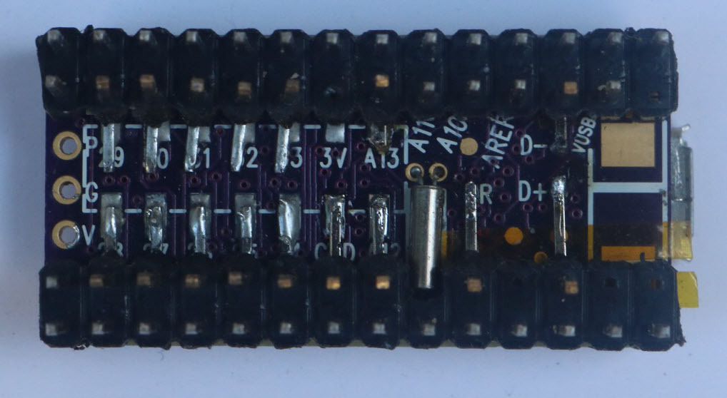

    this is what the teensy 3.1 looks like, bottom view. I have inserted and removed this from a socket at least 100 times already with no problems.
    Notice the yellow Kapton tape I used to cover the other test points that were in the way.
    I still think this is the best solution to breakout all the bottom pins. And it is completely reversible if you do not want the pins later on your teensy.
    Too bad 3.1 is discontinued. I think the angled pins can still reach the new 3.2 reset and D+ and D- locations, but not sure if my current breakout board will work or not. Maybe it will with minor trace cut and rewiring and some Kapton tape.
    edit--
    I just noticed in my earlier post picture I did not have the reset and D+ D- pins yet on the teensy.
    I simply slid the pin header plastic up, added more pins and slide the plastic back. Hence this mod is completely reversible or can be altered if you later needed a different configuration.
