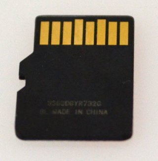

Would you mind telling which cards you are using? Although we've tried another set of cards with no luck.
Front side
Back side
Maybe check your wiring?
Checked it multiple times... Even tried soldering to the pins instead of using the breadboard, just in case. The strangest part is that code runs fine if I substitute line SPI.transfer(0X15); for SPI.transfer(0XFF); or SPI.transfer(0XFE);... So depending on the byte I send before writing to the SD card the write either fails or it doesn't.
I've ordered the SanDisk card, hope it works...

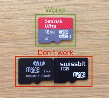

Just wanted to update you all on my ordeal with the weird behaviour of my SD cards.
This I believe is relevant for anyone trying to put an SD card with another device on the same hardware SPI bus and trying to access that other device in between writes to a contiguous file on the SD card.
So I ordered the SanDisk card that Paul has posted and it works just fine no matter what I try to send between the writeStart and writeData commands.
The cards that didn't work for me are:
ATP 1GB: http://uk.rs-online.com/web/p/secure-digital-cards/7761917/
Swissbit 1GB: http://uk.mouser.com/ProductDetail/...=sGAEpiMZZMtyMAXUUxCBEx7plPSciXQAAyUic2qnjWo=
Now, these cards that didn't work are industrial grade and have proper data sheets which specify their current draw during write in addition to leakage currents etc. The SanDisk cards don't seem to have any proper data sheets (or at least I haven't found these). I was wondering if anyone can name any other cards I could try which have proper data sheets?
Here's the picture of the cards described above:

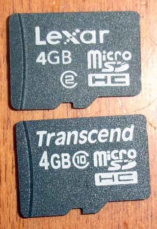

FYI - It fails on my Teensys... I am using micro SD adapters that are part of some Adafruit TFT displays, so like Paul have to change to CS=4...
With Lexar 4GB Micro SD HC, I receive the error:
Type any character to start
Free RAM: 57279
Start raw write of 5120000 bytes at
51200 bytes per second
Please wait 100 seconds
error: writeData failed
SD errorCode: 0X15,0X0
Note: I am able to run the SDCard example programs quickstart and I just used their sdformater program to initialize this card.
Now try again with 2nd card and get the same error. This is a Transcend 4gb 10 micro SD HC
Again this card was earlier formated using the SDFat format program and still works with their quickstart program:
