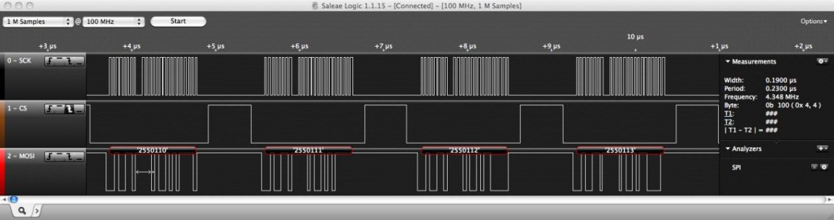

A question to those more experienced with git:
The DmaSpi library for teensyduino 1.20 RC2 is currently in a separate branch (not master). The older version (for 1.18) also has its own branch. Would it be better to merge the 1.20 branch into master? When people clone the repo or arrive at the repos website, the branch that is shown is the master, which might not be what they want.
I'm gonna test with 3 libraries, TFT_ILI9163, gpio_expander and LiquidOLED tomorrow, I've already modified the code and compile without errors, just curious to see the DMA on LiquidOLED wait routine that use spi reading, it should be much faster and no more waits!
Have you used the previous DmaSpi library before? I have not yet updated the chip select classes, I'll do that tomorrow. The chip select objects have to configure the SPI for your device (speed, mode) and also handle the CS pin. There is a simple ActiveLowChipSelect class in ChipSelect.h which you can modify to apply the correct SPI settings.

OK I've commited a slight change to ChipSelect.h for you to try. A dry test seemed to work well. I'll update the example sketch in the first post to demonstrate the new ActiveLowChipSelect class (edit: done).
oh, thanks! My bad I was try to understand why CS not work as suppose, I didn't read entirely your first post! I will try later the new change!
Sorry for delay christoph, I'm actually in a tiny island in greece and yesterday 12 hours of blackout, also internet hyperslow and almost unavailable most of the time, I'm actually power internet, notebook and Teensy with solar power. I had no luck with some TFT libraries so I decided to start again with some more basic, a GPIO chip (MCP23S17) but still no luck, I try to upload here the code I used, maybe I'm missing something!
That sounds great, actually!
Post your code and I'll have a look if you're using DmaSpi correctly. If that's the case, stay tuned for more commits, as I've already thought about modifying it a bit.
Here is my current DmaSpi code that should be working well. I worked through the internals and made two tests, one with a simple loopback (example sketch included) and one with external shift registers. If it doesn't work for you, please post the code you used for me to have a look.
Regards
Christoph
WARNING: The attached file is outdated. A newer version can be found in post #21 (http://forum.pjrc.com/threads/26479-DmaSpi-for-teensyduino-1-20-RC2?p=55837&viewfull=1#post55837)
  • DmaSpi.zip
I have been looking into DMA SPI transfers and came across your library. Unfortunately, when compiling the example code, I get the following error:

OK, so I guess it's not just me then. I am still having some issues. It's getting caught up in the while(trx.busy()); loop.
I am trying to make 24 bit word transfers using SPI at 24 MHz, and was hoping DMA + SPI would help eliminate the gap in sending 8 bit + 16 bit words within one chip select assertion. I have done this previously with the Arduino Due and it worked well using DMA, so I had hopes for the Teensy as well. My existing code yields the following. Notice the ~100ns delay between 8 bit and 16 bit frames.

This seems to be working, although I will run it through some more tests. I found I had to add an #include <SPI.h> header. But no big deal.
I am communicating with a device that uses 24 bit words, but since the ARM doesn't support words longer than 16 bits, I have to separate this into separate 8 and 16 bit words, and send them back to back within one CS assert. This is working pretty well, but leaves the 100 ns gap between the words. I can guarantee that the entire 24 bits are contiguous since they are held as a 32 bit uint on the ARM (I only care about the lower 24 bits). I was really hoping that DMA would reduce this gap as it did on the Due.
OK, then it's at least possible to make a 3-byte transfer using DmaSpi. But if you need single 3-byte transfers between a pair of CS assert/deassert, you won't get an overall increase in speed because the amount of data is simply too small. So what is the goal you are trying to achieve by getting rid of the 100 ns gap?
I appreciate the help on this, Christoph. I am communicating with a sensor that send 24 bit words at 24MHz. I am not sure how the sensor will behave with a short gap between the 8 bit and 16 bit frames. So, aside from the elegance factor keeping the 24 bit frame together in one uniformly spaced piece, I am also interested in reducing latency as much as possible as this may reduce the overall readout rate of the sensor. Granted, I seem to be getting over 500k 24 bit words per second (12Mbs) each with individual CS asserts/deasserts, so this might be acceptable. Thanks again for the great work.
With a little hacking you can create a self-repeating chain of transfers, say 8, and a custom chip select class. Together they could feed a FIFO with timestamped values.
