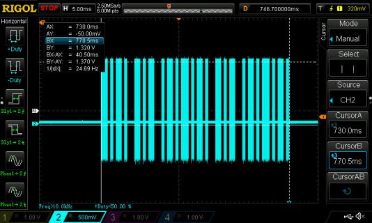

The problem: Audio library while playing files will not return reliable timings even when using interrupt based timers.
Question: Can someone replicate this problem? If so, any solutions available would be amazing to aid in my company product progress.

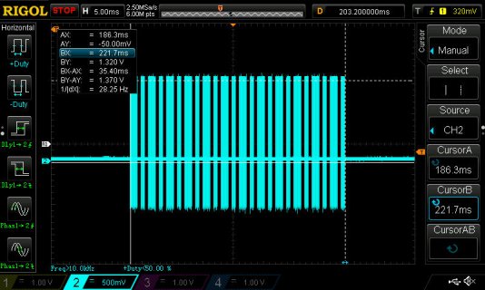

  ///////////turn audio off briefly while crating a waveform that pulses on/off on pin 25 at 38khz at 1200uS then 600uS with 600uS spacer ///////////
  AudioNoInterrupts(); //enable this line to fix waveform
  for (byte x = 12; x >0; x--)
    oscillationWrite_new(25, 1200); //send start bit, actually first bit
    IR_spacer(25,600);
    oscillationWrite_new(25, 600); //send start bit, actually first bit
    IR_spacer(25,600);
  AudioInterrupts();  //enable this line to fix waveform
  wav.play("059AP.RAW"); //play the sound effect, can use any sound here w/ same results
  // AudioNoInterrupts(); //enable this line to fix waveform
  /////////// next waveform will have timer delays about every 6ms that last about 0.7ms ////////////
    IR_spacer(25,600);
    IR_spacer(25,600);
  // AudioInterrupts();  //enable this line to fix waveform

expected waveform
second waveform will have unexpected delays causing the overall time to be wrong, roughly a delay every 6ms

First, I need to point out the incorrectness of your summary, specifically this:
Understanding this problem is important, for you and perhaps anyone else who later finds this thread and needs to do a similar thing. Before talking about specific solutions, I want to make sure you and anyone else finding this later understand this issue.
The ARM interrupt system uses priority levels, where lower numbers mean higher priority. 0 is the highest priority. Most interrupt default to priority level 128. The lowest interrupt priority is 255. Your Arduino sketch effectively runs at priority level 256.
The ARM interrupt controller allows nested interrupts, up to 16 levels deep, so higher priority interrupts can run even when a lower priority interrupt has control. This is fundamentally different than 8 bit AVR, which most people familiar with AVR understand, where there is no interrupt priority scheme. On AVR, you have to enable all interrupts if you want any to be able to work. On ARM, when an interrupt at priority level 128 is running, all code at levels 128 to 256 is unable to run, but all interrupts assigned a higher priority can still interrupt it.
The audio library uses 2 types of interrupts. There are short duration interrupts for the DMA channels, which today run at priority level 128. Future versions of the audio library might assign these higher priority, probably 96. The actual computation of audio data is done with a low priority interrupt. Today it's assigned level 255. Future versions will likely raise it to 224.
The timing accuracy of any code is impacted by all interrupts that run at the same or higher priority.
In the code above, you're using an IntervalTimer, but all it's doing inside its interrupt is incrementing a number. You've raised the priority to the highest level, so the the increment of that number will happen with very good timing accuracy.
However, your code that actually reads the number is still in the main program, running at the very lowest priority level. While the audio library's low priority interrupt does lots of calculations and I/O if using the SD card, that number keeps incrementing with very accurate timing, but your code that responds to the number can't run, so the net result it poor timing.
To make this work properly, you're going to have to move more of the code into that high priority interrupt. Since you're trying to create a waveform to drive a IR LED, you're going to need to turn the PWM signal on/off within that interrupt.
5 microseconds is certainly much faster than you need. Even a single cycle of 38 kHz is 26.3 us. You should redesign your code to run the IntervalTimer interrupt at the moments when you need to turn the PWM waveform on/off. You can call analogWrite() from within the interrupt. It will give you extremely reliable timing. Of course, the 2 challenges in any interrupt-based programming are limiting the time your interrupt runs (especially if it's at a very high priority) and properly sharing data between the main program and the interrupt.
Hopefully this lengthy explanation helps you to revise this code. I want to be absolutely clear, this timing resolution issue you're seeing is fundamentally how the hardware and interrupt system works. It's not a bug in the audio library. It's simply how things are. To make your project work as you want, you have to design your code to use the system's higher priority interrupts to do your timing critical work (not merely increment a variable), while hopefully keeping your high priority interrupt usage short enough to not mess up the audio library and other stuff.

I shall give this a shot tomorrow. Excellent explanation. I will try to create interrupt driven IR output routine which will probably be 30ms, a bit long, but it that's the only way to keep the timings accurate, i'll give it a shot, probably at 130 priority first.
SWEET. I got it working. I will fine tune the real code tomorrow, but this demo worked great. SUPER HAPPY, thanks for pointing out the obvious hardware interrupt issues to me. I think this was the last major hurdle I had with production plans. The rest should be gravy. Time to start making PCBs and make an order for some bootloaders in the next 2 months.
