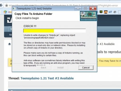

Hi, Teensyduino 1.20 and 1.21 with the same installation error. changed directory, but not resolved.
What can be? Thanks
Make sure Arduino is not running while you're trying to change it.
Temporarily disable your anti-virus or security software, which might be interfering with the installer's ability to modify another program. The installer never uses any network connectivity, so you can disconnect your network cable while anti-virus is disabled.
Since this is Windows, always try rebooting!
Yes, I disabled Avira and disconnected from the Internet and installed normally. Thank
