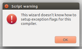

  5. Select your teensyduino arm gcc compiler. If you haven't configured it yet, abort and do that now (how?). It's also possible to change the compiler later, but beginners might run into problems with that.
    If Code::Blocks complains that it doesn't know how to set exception flags for this compiler: That's ok, we'll do that later.02_1_exceptions_warning.png

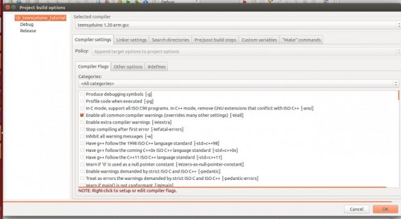

Now we have the files and compiler set up, but Code::Blocks doesn't know what compiler flags to set, where include files should be searched for, and so on. These will be covered in the next post.
Build options can be set for the top-level project and each target. Most options are equal for all targets, though.
  • Right-click the project root again and go to the build options. Select the top-level item in the target tree on the left:
  • Tab: Compiler Settings -> Tab: Other Options:

The top-level options are fine now, but the individual target need some fine-tuning.
  1. Debug Target: Go to "Compiler Settings" -> "Compiler Flags" and enable "Produce debugging symbols [-g]"
  2. Release Target: Go to "Compiler Settings"-> "Compiler Flags" and enable "Strip all symbols from binary (minimizes size) [-s]"
Hit OK to close the build options. In one of the above steps we have configured arm-none-eabi-size, arm-none-eabi-objcopy and arm-none-eabi-objdump to manipulate the build output - but they won't find the output file yet. How this is named is given in the "Project Properties".
