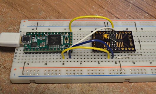

I tested with a Winbond W25Q64FV chip connected to Teensy 3.1, using Teensyduino 1.21-test2.
Here's how I connected everything:
Because a complete program wasn't provided, I had to write one for testing.

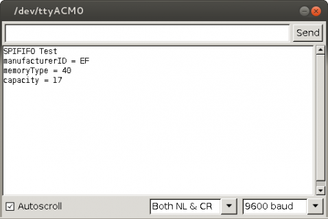

Here's what I see in the serial monitor:
(click for full size)

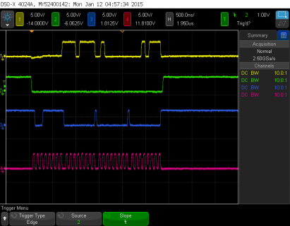

It certainly seems to be working properly. Just to make sure, I connected my oscilloscope.
Had you posted a complete program, I would have tested with your code and likely found the cause of your trouble. But when the forum rule isn't followed, this is the best I can do. Hopefully it helps?
