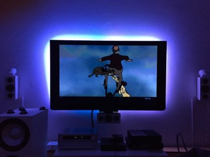

My friend wanted to build Boblight for his TV and we decided to use Teensy 3.1 with OctoWS2811 shield for that. Could not find anyone who has already done this, so I decided to share the scetch i made for this.
There is only this part you need to modify in addition to the normal settings:
// Led strip lengths, (0 if there is no strip):
#define STRIP_1  86
#define STRIP_2  47
#define STRIP_3  84
#define STRIP_4  47
#define STRIP_5  0
#define STRIP_6  0
#define STRIP_7  0
#define STRIP_8  0
// ledsPerStrip has to be >= the longest led strip
const int ledsPerStrip = 90;
We made it so that first LED strip is bottom, second is left, third is top and fourth is right. When you have these lenghts set correctly, the code will chain installed LEDs automatically between 0 and LEDCOUNT.

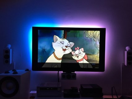

I asked for him to take some pics and here those are:
The colors look quite bad on those pictures, in reality colors match really well the video. If you have some specific video to test i can ask him to try that.
