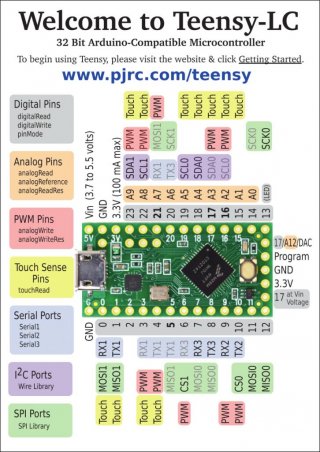

Here is a first draft for the front side of the reference card.
Why are the labels for pins 5, 16, 17 and 21 bold?
There is hardly any difference in the colors for digital pins and serial ports - maybe make it more prominent?
On 3.* cards, pin between Vin and 3.3v was marked as AGND
and shouldn't A12/DAC be 26 not 17?
the red dots for 20ma pins was nice addition as per Nantonos draft, though I guess your bold for 5,16,17,21 conveys that info (steganography)
There are probably a few other alternate pins that potentially could be marked. Example CS on pin 2?
Also my built table could be wrong, but wondering about PWM on pin 21?
