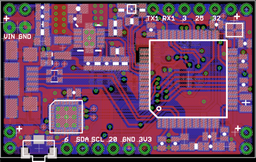

What do you mean with "The 5x5mm QFN bootloader chip also needs fewer capacitors, is smaller, and requires no via transitions to be implemented"?
It means that I was able to implement the smaller bootloader chip without the need for vias when connecting to the MK20 on a 2-layer board. I happen to suffer from a bit of OCD when it comes to maintaining a unbroken GND plane on one side of my 2-layer designs. The smaller QFN chip is hence easier to implement for me. I didn't get so lucky with the MKL02 bootloader version. Note how it features two 0-Ohm jumper resistors.
Just thought would show a little as well as tell.

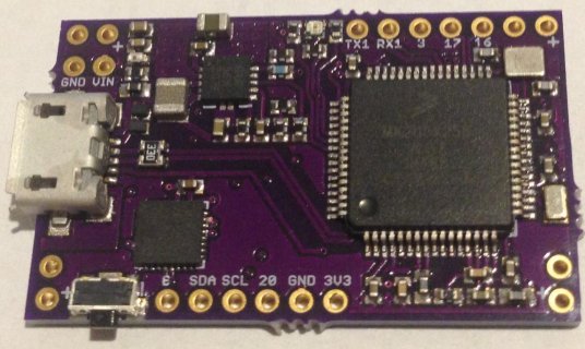

This is the board I put together that doesn't work:
you can recognize this as a modified version of Phillip Schuster's reference design.
and this is what the revision will look like:
You can see I've added test points to better diagnose what else goes wrong...
My ocd manifests as a desire to wring every last square mm of space out to make the smallest board possible. Haven't really got started here yet since I need to just make it work, but i am aiming for another 10% reduction with more components to add...
That's very cool. Is this a 4 layer board or 2? If 2, I wonder to what extent you may also be having issues with the crystal not being happy on account of the GND plane around it. In the image above, you can see how I have moated the crystal, the two crystal lines are the same length (measured in eagle) and a crystal GND plane surrounds the crystal, joins the two GND pads of the crystal, then goes under the MCU and joins the crystal GND to the GND pin there. The GND return path from the 0.1uF decoupling capacitor to MCU GND is separate (i.e. the GND from the crystal joins underneath the MCU, the crystal GND joins from the outside). That way, the GND path to the crystal will never feature junk from the decoupling cap and vice versa.
I can see why you chose to put the bootloader where you did but I prefer mine as close to the pins in question as possible. Hence what you see above.
It is four, with a GND and 3V3 plane beneath the xtal then some components below. I'm not too happy about the latter but it is a compromise for small size. But the inner layers should shield well enough. I don't think this is the problem but maybe a problem later on. But this xtal and this kind of layout work well on the nRF51822.
I am hoping it is the missing GND pins on the MINI54TAN that is my problem. I will know in a couple of weeks.
