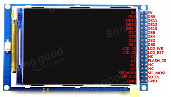

Hi guys,
sorry for this dumb question, but i bought me this HX8357C display and while looking at the pins and some example code I am completely confused
how would i connect it to my teensy 3.2 ?? .. What is this SD_CS pin?
from the example:
// For the Adafruit shield, these are the default.
#define TFT_DC 9
#define TFT_CS 10
#define TFT_MOSI 11
#define TFT_MISO 12
#define TFT_CLK 13
//Adafruit_ILI9341 tft = Adafruit_ILI9341(TFT_CS, TFT_DC);
// If using the breakout, change pins as desired
Adafruit_ILI9341 tft = Adafruit_ILI9341(TFT_CS, TFT_DC, TFT_MOSI, TFT_CLK, TFT_RST, TFT_MISO);
where would i connect TFT_DC and TFT_CS on the display?
can someone give me a help?
The display is using 16 bit bus mode and needs about 20 Teensy pins. As far as I know there is no existing library for Teensy.
The SPI pins/bus is for the SD Card and the flash chip. SD_CS is the chip select for the SD Card
can't i just use the Adafruit_ILI9341 for this?
it is a display for arduino mega.. shuld i maybe build me a "mega on a breadboard" and control it via the teensy?
No, the display won't work with the Adafruit_ILI9341 library. The reason is that the Adafruit_ILI9341 uses the SPI interface for the display and your display is configured for a 16 bit interface.
oh,.. i understand :/ .. hmm.. is there a shield or some other solution for that? what would I need to get this working? or should i buy a other display?

A quick glance shows that this shield expects/sends 5v signalling (since the Mega runs on 5v). So you would need to do the appropriate level shifting to convert the Teensy 3.3v signals (both ways) to 5v, and then the shield converts them back to 3.3v.
please correct me if i am wrong, but is the VIN-pin on the teensy 3.2 not 5v ??
The VIN pin is whatever voltage you connected to your Teensy (5v if you use USB) in the range of around 3.6-6v.
However, the point I was trying to make was all of the data pins would expect 5v input and send 5v outputs. Now, if the shield is setup to recognize 3.3v that the Teensy sends, and you use the Teensy 3.2 or 3.5 (but not the LC or 3.6) to read the digital inputs, then it may work. However, if the device is expecting only 5v, it may not work.
Given the Teensy does not use the Mega form factor, you would have to run a lot of wires to adapt the code to meet the shield, and change the code for the appropriate Teensy pins, I'm not sure the shield buys you anything. Just run the wires directly to the display. Note, on a 3.2, you likely will need to use the bottom solder pads to get the number of pins. There are breakout boards to give you easier access to those pins (or just get a Teensy 3.5/3.6 to get more pins in easily accessible locations).
I suspect if you work at enough, you might be able to get the display to work. However, at the end of the day, it may be simpler to get a display that uses SPI (or i2c/serial UART) and has a known working driver. Its your call.

thanks for the explanation.. yes I do feed the teensy via USB.. therefor my VIN is 5v
I have wired the display directly to the teensy 3.2 .. the backlight seems to work when 5V and GND is connected.. but the rest..sorry i am a completely noob at this.. not :/ .. and i completely do not know where to start..
i mean, .. how would i wire it? .. do i have to use all pins?

That's why I think it would be simpler to look for a supported display. Where to start? You would need to get the datasheet to find the pin assignments and what the commands are for the display. If the code for the Mega shield is available, you could potentially use it as a starting place for writing your code, unless it is hard-wired to the Mega using assembly code that won't port easily to the Teensy.
Some displays have an option to switch to 4 pin SPI mode, in which case you would wire the appropriate switch high/low (and use the appropriate SPI library). But if it doesn't have a SPI mode or there isn't a SPI library for the display, you are in for a tough slog.

thank you very much :)
I found a libary for exactly my display, that should work with teensy 3.2
http://www.rinkydinkelectronics.com/library.php?id=51
unfortunately i have alredy soldered the side-pins on my teensy and can't get them unsoldered to get it all on the breakout-board .. so i ordered a new teensy :D .. and now i'm waiting..
anyway.. there are soooo many nice displays out there.. is there a basic-tutorial on dispays? .. what about the industrial displays.. do all displays work the same way? .. i mean, it would be really nice to use anything that I think looks nice, e.g. an old smartphone-display.. or a display from an old midi-controller, etc.
