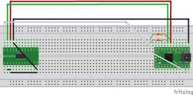

A PCA9655E I/O expander is connected to a Teensy 2.0 via I2C.
PCA9655E I/O expander is on the left and Teensy 2.0 on the right:
There is nothing connected to the PCA9655E port pins.
When I run the sketch:
1110 is output to port 0.
1110 is read from port 1.​
How did data get from port 0 to port 1?
There is nothing connected to the port pins.

const uint8_t ADDR  = 0x20;                     //PCA9655E I2C address with AD2 AD1 AD0 grounded
should the Address not be 0x40 (A0,A1,A2) grounded and 0x20 for (GND,SCL,GND)?
also you could try to put input port to GND and see what you read

Since the pins are pulled high, and the port pins are not connected to anything, I am expecting port 1 to read 11111111.
But the port 1 reading is 00001110, which is the value of the port 0.
How did data get from port 0 to port 1?:confused:

what happens if you read always two or four bytes (it should toggle between port 0 and port1)?
Thanks for the suggestion WMXZ.
The Wire library shifts the 0x20 ADDR left one bit (giving 0x40) and then ors in 0 or 1 for write or read.
This was confirmed by another sketch that worked.
Did you try simply putting 0x40 into your program? From the datasheet's table on page 7, that really does look like the address for your wiring diagram.
Also you could try
Wire.endTransmission(false);
to avoid the stop between writing the command byte and the read
solved
Thanks Paul, for your suggestion. But I think WMXZ figured it out.
output with Wire.endTransmission(false):
port1 = 11111111
port1 = 11111111
port1 = 11111111
port1 = 11111111
port1 = 11111111
port1 = 11111111
port1 = 11111111
port1 = 11111111
It makes sense after reading the PCA9655E datasheet and Arduino reference:
Reading the Port Registers
After a restart, the device address must be sent again, but this time, the least significant bit is set to logic 1.
Data from the register defined by the command byte will then be sent by the PCA9655E.
http://www.onsemi.com/pub_link/Collateral/PCA9655E-D.PDF
Wire.endTransmission() Parameters stop : boolean.
true will send a stop message, releasing the bus after transmission.
false will send a restart, keeping the connection active.
http://arduino.cc/en/Reference/WireEndTransmission
The Arduino library automatically takes care of things, if the parameters are just right.
