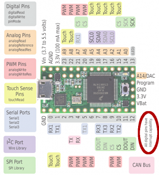

though attachInterrupt() is documented, I couldn't find a newbie definition of which pins are usable for external interrupts.
For the Teensy 3.1 - as per the little reference card - 'All digital pins have interrupt capability'. So pins 0 through 33 :) Just use, attachInterrupt(23, func, LOW/HIGH/etc);
Yup, it's on the pinout card.
There's already a lot of info on the card, taking up all the available space. If it printed "INT" on every pin, it'd require making everything else a bit smaller. Maybe that would be a good trade-off? Maybe not?
