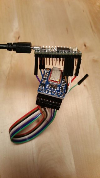

I tried uncommenting the hardware serial part and using Serial2 last night, but I'm not sure how I messed up. Waking up today with a clear head, I tried again with Serial1, and no dice... Then I realized that I had the TX and RX pins switched... Oops. Here's the final code below for anyone that may come across this from a search engine.

#define BLUEFRUIT_SWUART_RXD_PIN        1    // Required for software serial!
#define BLUEFRUIT_SWUART_TXD_PIN        0   // Required for software serial!
#define BLUEFRUIT_UART_CTS_PIN          11   // Required for software serial!
#define BLUEFRUIT_UART_RTS_PIN          2   // Optional, set to -1 if unused
// If you are using Hardware Serial
// The following macros declare the Serial port you are using. Uncomment this
// line if you are connecting the BLE to Leonardo/Micro or Flora
#define BLUEFRUIT_HWSERIAL_NAME           Serial1
// Other recommended pins!
#define BLUEFRUIT_UART_MODE_PIN         12   // Optional but recommended, set to -1 if unused

Hi all,
I am posting into this thread, because I try exactly the same code posted above on the Teensy 3.2, which is similar to the Teensy 3.1.
There were only 2 changes I had to change:
//#include "Adafruit_BLE_HWSPI.h"
#include "Adafruit_BluefruitLE_SPI.h"
and
//ble.setModePin(BLUEFRUIT_MODE_DATA);
ble.setMode(BLUEFRUIT_MODE_DATA);
The serial monitor shows me always the same output, regardless what I am trying:
ATZ
<- ATZ
<- ATZ
<- ATZ
<- ATZ
<- ATZ
<- ATZ
<- Couldn't find Bluefruit, make sure it's in CoMmanD mode & check wiring?
Attached is a picture of my wiring.
Arduino version 1.8.1, Teensyduino version 1.35 and BluefruitLE nRF51 version 1.9.4
Could anyone help me please?
Robert
Dear Dobby
Did you find a solution for this problem? I also have teensy 3.2 and I'm getting the same error as you
Cheers
I found a solution after a more in-depth search in the pjrc forums, from this post:
https://forum.pjrc.com/threads/39644-Fastest-Bluetooth-Data-transfers-from-Teensy-to-Host-Should-I-use-SPI-What-module
which suggested adding
#define TEENSY_CTS_PIN 11
#define TEENSY_RTS_PIN 8
hs->attachCts(TEENSY_CTS_PIN);
hs->attachRts(TEENSY_RTS_PIN);
to Adafruit_BluefruitLE_UART.cpp right after the call to hs->begin(9600)
This solved the issue for me (I was using teensy hardware serial interface Serial2)
Cheers
Thanks for the hint phuijse. It is now working also in my case, but with a small difference:
Adafruit_BluefruitLE_UART ble(BLUEFRUIT_HWSERIAL_NAME, BLUEFRUIT_UART_MODE_PIN,11,8);
The constructor needs 4 parameters in my library revision, that means CTS and RTS need to be set.
