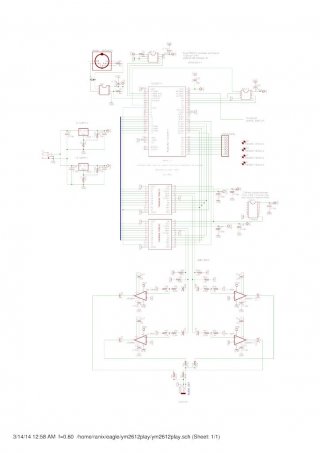

Howdy! That's my code, lol. I saw a YouTube comment about this thread and popped on over.
In order to use a Teensy 3.1 you'll need to level shift (3.3v -> 5v, single direction (write only) ) the 8 bit data bus and pins A0, A1, /RD, /WR, and /CS
It might be easiest to replicate a single YM2612 connected to a Teensy 2.0 or Teensy++ first, and then get the Teensy 3.1 working. I have not yet upgraded my device to a Teensy 3.1 because I haven't had the time. The 2.0 is fine for most things a synth would do but has trouble keeping up with playing back VGM files - reading and writing the embedded PCM data from a VGM file over USB or Serial is more than it can handle in real-time.
My code is heavily dependent on the ability of the Atmel chip to change the state of an entire bus (8 pins per bus on the Teensy 2) by using the PORTA, PORTB, etc. registers (or whatever those are). Basically you can do something like PORTD = 0x5 to set pins 1 and 3 high and all other pins low on bus D. This reduces the number of instructions you need to provide to manipulate the data bus dramatically and simplifies your code.
I believe the Teensy 3.1 also has busses that can be manipulated the same way, but I recall them having strange widths (one of them was like 4 bits wide, another was like 16 I think?) and may require some experimentation or advice from an ARM guru to get right.
Here's the schematic of the hardware that works with that code:
edit: forum mangulated the image, here's an imgur http://imgur.com/WodUFd8.png
Also sorry about not splitting out the different functions of the code into separate C files and stuff, I realize it's very hard to read. I didn't really know what I was doing when I wrote it.
Oh, by the way, you do NOT plug the YM2612 directly into speakers. You can do this for testing, but eventually this will damage the chip. It does NOT like impedance on the output stage and will heat up significantly. The original MegaDrive had a little headphone amp on the output, and the newer models (without the volume slider) had an op amp buffer if I remember correctly.
Again, this is OK to use for testing if you do not want to be troubleshooting your output stage hardware at the same time as you are troubleshooting the rest of your hardware / software, but replace the test YM2612 with a fresh one or re-test the output with a scope to make sure it's not damaged before assembling it into a final product, because it's likely to become damaged from that.

im nowhere near getting this to go, i just want to get all the information out there so someone as dumb as me would understand ;)
EDIT, here's the updated probably wrong still schematic
I realize that T3.1 maybe underpowered for the job, i only want to get it most of the way there programwise. are all the pins going to be digital between the T3.1 and YM2612 aside from the power in and audio out and grounds?
yep, it's still wrong. here's just a few things:
1. voltage levels: ranix above has confirmed it won't work with 3v3 logic (unlike opl3), so assuming that's correct, you'll *need* level shifters of some sort or another. there's plenty of threads around here covering that and possible ICs, too; see here for the most recent one: https://forum.pjrc.com/threads/29135-Appropriate-Level-Shifting-IC-to-interface-Teensy-LC-to-5V-chip
2. power supply. you still power the yamaha chip via teensy, the 3v3 pin in this case -- which might even work if this was spec'd at 3v3. as per the unreadable ym2608 manuals, the ym2612 chip seems to want 4.75v (min), 5v (typical). so you'll need 5v from somewhere. Vusb might work for testing, which can be tapped from the Vin pin; in a proper application / synth you'd probably want a separate supply, proper decoupling (that's the caps you see on power lines), etc.
3. pins used. if you think you need the port thing, take a good look at the tutorial that i've linked, and that mortonkopf linked again. you'll note it goes on at length about "PORTD" in particular, saying that whereas PORTD (AVR) maps to "7,6,5,4,3,2,1,0 in that order, GPIOD maps to pins 5,21,20,6,8,7,14,2, in that order!"

Trying to hook up the yamaha chip is a very ambitious project, you dont have a full data sheeht for it, it is non trivial to communicate with it both physically due to voltage differences and protocol wise and you are using an unfamiliar micro controller to do it all.
An excellent first step would be to hook up a sn76489 to a teensy instead. It accepts 3.3v inputs (although it needs 5v on Vcc) and by default when you power it up it is generating a tone, so to get it to make a sound al you need to do is attach a 4mhz clock and power - job done no need for any microcontroller! Once you have it saying "booooooooooooooooooo" you ca attach the teensy and start playing with the very simple protocol to play different notes.
This way is a lot gentler than battling with the yamaha chip and you satisfying feed back early in the process.
